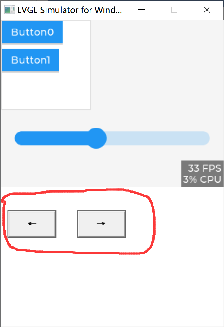

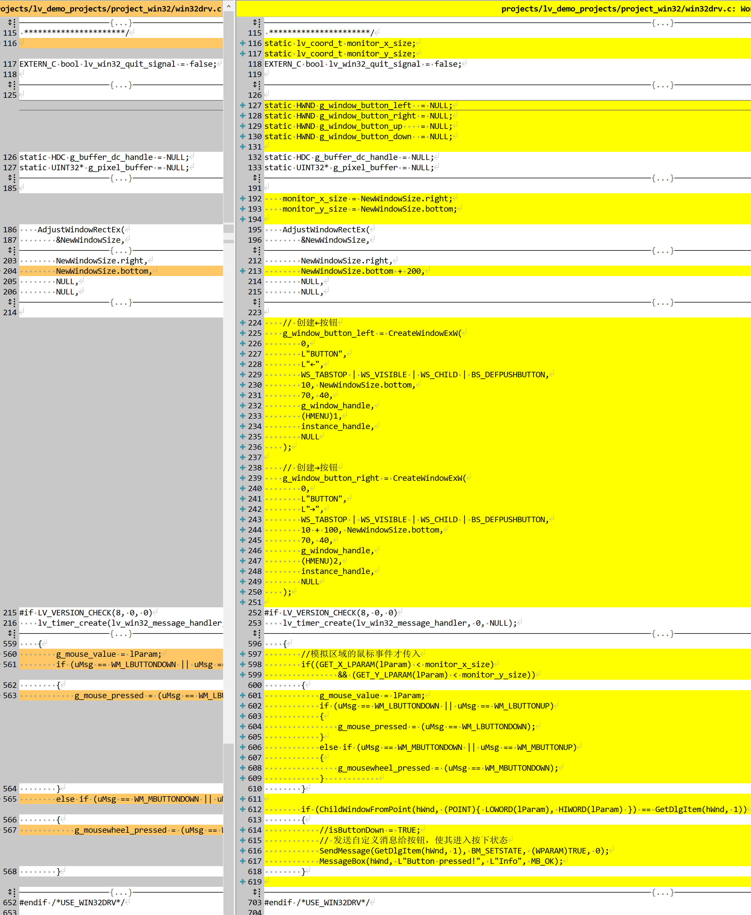

LVGL win32 添加模拟器按键

static HWND g_window_button_left  = NULL;
static HWND g_window_button_right = NULL;
static HWND g_window_button_up    = NULL;
static HWND g_window_button_down  = NULL;

    // 创建←按钮
    g_window_button_left = CreateWindowExW(
        0,
        L"BUTTON",
        L"←",
        WS_TABSTOP | WS_VISIBLE | WS_CHILD | BS_DEFPUSHBUTTON,
        10, NewWindowSize.bottom,
        70, 40,
        g_window_handle,
        (HMENU)1,
        instance_handle,
        NULL
    // 创建→按钮
    g_window_button_right = CreateWindowExW(
        0,
        L"BUTTON",
        L"→",
        10 + 100, NewWindowSize.bottom,
        70, 40,
        g_window_handle,
        (HMENU)2,
        instance_handle,
        NULL

        //模拟区域的鼠标事件才传入
        if((GET_X_LPARAM(lParam) < monitor_x_size)
                && (GET_Y_LPARAM(lParam) < monitor_y_size))
            g_mouse_value = lParam;
            if (uMsg == WM_LBUTTONDOWN || uMsg == WM_LBUTTONUP)
                g_mouse_pressed = (uMsg == WM_LBUTTONDOWN);
            else if (uMsg == WM_MBUTTONDOWN || uMsg == WM_MBUTTONUP)
                g_mousewheel_pressed = (uMsg == WM_MBUTTONDOWN);
        if (ChildWindowFromPoint(hWnd, (POINT){ LOWORD(lParam), HIWORD(lParam) }) == GetDlgItem(hWnd, 1))
            //isButtonDown = TRUE;
            // 发送自定义消息给按钮,使其进入按下状态
            SendMessage(GetDlgItem(hWnd, 1), BM_SETSTATE, (WPARAM)TRUE, 0);
            MessageBox(hWnd, L"Button pressed!", L"Info", MB_OK);
