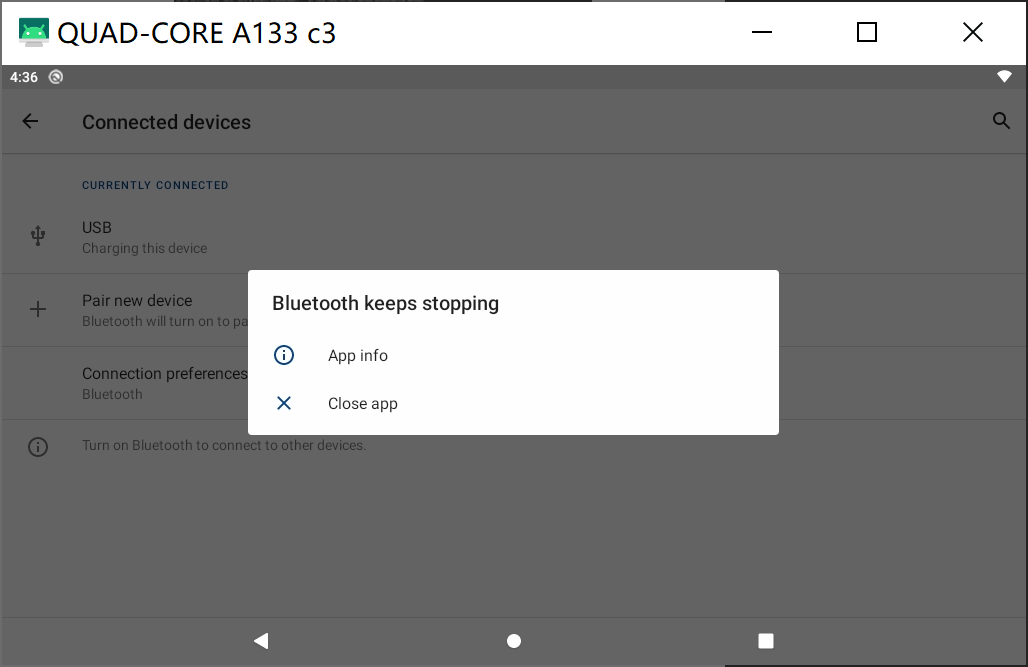

A133 AW869C 蓝牙开启失败,请问是什么原因呢?

12-04 16:40:01.182  2451  7203 D BluetoothManagerService: enable(com.android.settings):  mBluetooth =null mBinding = false mState = OFF
12-04 16:40:01.182  2451  7203 D BluetoothManagerService: enable returning
12-04 16:40:01.182  2451  2492 D BluetoothManagerService: MESSAGE_ENABLE(0): mBluetooth = null

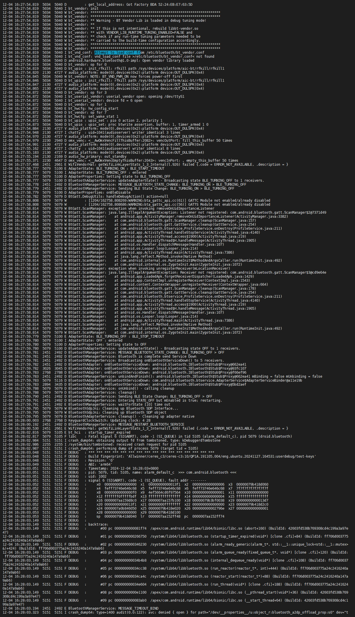

12-04 16:40:01.520  8620  8620 I         : [1204/164001.520505:INFO:com_android_bluetooth_btservice_AdapterService.cpp(628)] hal_util_load_bt_library loaded HAL: btinterface=0x79b8b64440, handle=0x2ad82ce9145ff26d
12-04 16:40:01.521  8620  8620 D BluetoothAdapterService: onCreate()
12-04 16:40:01.526  2130  4727 V audio_platform: mode(0),devices(0x2):platform device:OUT_DULSPK(0x4)
12-04 16:40:01.528  8620  8620 D AdapterState: make() - Creating AdapterState
12-04 16:40:01.528  2230  2230 D omx_venc: <__AwOmxVencFillThisBuffer:2082>: vencOutPort: fill_this_buffer 50 times
12-04 16:40:01.531  8620  8660 I AdapterState: OFF : entered
12-04 16:40:01.531  8620  8660 D AdapterProperties: Setting state to OFF
12-04 16:40:01.532  8620  8620 I bt_btif : init: start restricted = 0 ; single user = 0
12-04 16:40:01.532  8620  8620 D bt_osi_allocation_tracker: canary initialized
12-04 16:40:01.533  8620  8661 I         : [1204/164001.533189:INFO:message_loop_thread.cc(175)] Run: message loop starting for thread bt_stack_manager_thread
12-04 16:40:01.533  8620  8661 I bt_stack_manager: event_init_stack is initializing the stack
12-04 16:40:01.536  8620  8661 I         : [1204/164001.536857:INFO:btif_config.cc(647)] hash_file: Disabled for multi-user
12-04 16:40:01.536  8620  8661 I         : [1204/164001.536961:INFO:btif_config.cc(675)] read_checksum_file: Disabled for multi-user
12-04 16:40:01.537  8620  8661 E bt_btif_config: Config is missing adapter section
12-04 16:40:01.537  8620  8661 W bt_btif_config: init unable to load config file: /data/misc/bluedroid/bt_config.conf; using backup.
12-04 16:40:01.537  8620  8661 I         : [1204/164001.537382:INFO:btif_config.cc(647)] hash_file: Disabled for multi-user
12-04 16:40:01.537  8620  8661 I         : [1204/164001.537440:INFO:btif_config.cc(675)] read_checksum_file: Disabled for multi-user
12-04 16:40:01.537  8620  8661 W bt_btif_config: init unable to load backup; attempting to transcode legacy file.
12-04 16:40:01.538  8620  8661 E bt_btif_config_transcode: btif_config_transcode unable to load XML file '/data/misc/bluedroid/bt_config.xml': 3
12-04 16:40:01.538  8620  8661 E bt_btif_config: init unable to transcode legacy file; creating empty config.
12-04 16:40:01.538  8620  8661 W         : [1204/164001.538167:WARNING:btif_config.cc(151)] read_or_set_metrics_salt: Failed to read metrics salt from config
12-04 16:40:01.538  8620  8661 I         : [1204/164001.538239:INFO:btif_config.cc(162)] read_or_set_metrics_salt: Metrics salt is not invalid, creating new one
12-04 16:40:01.539  8620  8661 E bt_osi_alarm: timer_create_internal unable to create timer with clock 9: Unknown error 524
12-04 16:40:01.539  8620  8661 E bt_osi_alarm: The kernel might not have support for timer_create(CLOCK_BOOTTIME_ALARM): https://lwn.net/Articles/429925/
12-04 16:40:01.539  8620  8661 E bt_osi_alarm: See following patches: https://git.kernel.org/cgit/linux/kernel/git/torvalds/linux.git/log/?qt=grep&q=CLOCK_BOOTTIME_ALARM

12-04 16:40:05.630  8620  8660 E AdapterState: BLE_TURNING_ON : BLE_START_TIMEOUT
12-04 16:40:05.630  8620  8660 I AdapterState: BLE_TURNING_OFF : entered
12-04 16:40:05.630  8620  8660 D AdapterProperties: Setting state to BLE_TURNING_OFF
12-04 16:40:05.630  8620  8660 D BluetoothAdapterService: updateAdapterState() - Broadcasting state BLE_TURNING_OFF to 1 receivers.
12-04 16:40:05.631  2451  2492 D BluetoothManagerService: MESSAGE_BLUETOOTH_STATE_CHANGE: BLE_TURNING_ON > BLE_TURNING_OFF

12-04 16:40:06.584  2768  2768 W KeyButtonRipple: mSupportHardware: true mDark: true mLastDark: true pressed: false
12-04 16:40:06.586  2768  2768 I KeyButtonView: Back button event: ACTION_UP
12-04 16:40:06.588  2451  2491 D AutofillManagerService: onBackKeyPressed()
12-04 16:40:06.588  2451  2638 V InputDispatcher: Asynchronous input event injection succeeded.
12-04 16:40:06.593  2130  4727 V audio_platform: mode(0),devices(0x2):platform device:OUT_DULSPK(0x4)
12-04 16:40:06.614  2130  4727 V audio_platform: mode(0),devices(0x2):platform device:OUT_DULSPK(0x4)
12-04 16:40:06.633  8620  8660 E AdapterState: BLE_TURNING_OFF : BLE_STOP_TIMEOUT
12-04 16:40:06.633  8620  8660 I AdapterState: OFF : entered
12-04 16:40:06.633  8620  8660 D AdapterProperties: Setting state to OFF
12-04 16:40:06.634  8620  8660 D BluetoothAdapterService: updateAdapterState() - Broadcasting state OFF to 1 receivers.
12-04 16:40:06.634  2451  2492 D BluetoothManagerService: MESSAGE_BLUETOOTH_STATE_CHANGE: BLE_TURNING_OFF > OFF
12-04 16:40:06.634  2451  2492 D BluetoothManagerService: Bluetooth is complete send Service Down
12-04 16:40:06.634  2451  2492 D BluetoothManagerService: Broadcasting onBluetoothServiceDown() to 5 receivers.
12-04 16:40:06.635  2130  4727 V audio_platform: mode(0),devices(0x2):platform device:OUT_DULSPK(0x4)
12-04 16:40:06.635  2451  2492 D BluetoothAdapter: onBluetoothServiceDown: android.bluetooth.IBluetooth$Stub$Proxy@b27333
12-04 16:40:06.635  3026  3045 D BluetoothAdapter: onBluetoothServiceDown: android.bluetooth.IBluetooth$Stub$Proxy@bf2291e
12-04 16:40:06.636  2768  2786 D BluetoothAdapter: onBluetoothServiceDown: android.bluetooth.IBluetooth$Stub$Proxy@407851d
12-04 16:40:06.636  2451  2492 D BluetoothManagerService: unbindAndFinish(): android.bluetooth.IBluetooth$Stub$Proxy@b27333 mBinding = false mUnbinding = false
12-04 16:40:06.636  8620  8676 D BluetoothAdapter: onBluetoothServiceDown: com.android.bluetooth.btservice.AdapterService$AdapterServiceBinder@f0d0c95
12-04 16:40:06.636  2894  3435 D BluetoothAdapter: onBluetoothServiceDown: android.bluetooth.IBluetooth$Stub$Proxy@c170371
12-04 16:40:06.657  2130  4727 V audio_platform: mode(0),devices(0x2):platform device:OUT_DULSPK(0x4)
12-04 16:40:06.662  8620  8620 D BluetoothAdapterService: onUnbind() - calling cleanup
12-04 16:40:06.662  8620  8620 D BluetoothAdapterService: cleanup()
12-04 16:40:06.672  2451  2492 D BluetoothManagerService: Sending BLE State Change: BLE_TURNING_OFF > OFF
12-04 16:40:06.678  2130  4727 V audio_platform: mode(0),devices(0x2):platform device:OUT_DULSPK(0x4)
12-04 16:40:06.681  2451  2492 D BluetoothManagerService: Entering STATE_OFF but mEnabled is true; restarting.
12-04 16:40:06.681  8620  8620 W BluetoothSdpJni: Cleaning up Bluetooth SDP Interface...
12-04 16:40:06.681  2451  2492 E BluetoothManagerService: waitForState [10] time out
12-04 16:40:06.681  8620  8620 W BluetoothSdpJni: Cleaning up Bluetooth SDP object
12-04 16:40:06.681  8620  8620 D BluetoothAdapterService: cleanup() - Cleaning up adapter native
12-04 16:40:06.699  2130  4727 V audio_platform: mode(0),devices(0x2):platform device:OUT_DULSPK(0x4)
12-04 16:40:06.720  2130  4727 V audio_platform: mode(0),devices(0x2):platform device:OUT_DULSPK(0x4)
12-04 16:40:06.729  3194  3194 I Launcher: Launcher:onResume start
12-04 16:40:06.731  3194  3194 I Launcher: Launcher:onResume end
12-04 16:40:06.733  2230  2230 D omx_venc: <__AwOmxVencFillThisBuffer:2082>: vencOutPort: fill_this_buffer 50 times
12-04 16:40:06.753  2130  4727 V audio_platform: mode(0),devices(0x2):platform device:OUT_DULSPK(0x4)
12-04 16:40:06.774  2130  4727 V audio_platform: mode(0),devices(0x2):platform device:OUT_DULSPK(0x4)
12-04 16:40:06.797  2230  2940 D omx_venc: <__AwOmxVencEmptyThisBuffer:2043>: vencInPort: , empty_this_buffer 50 times
12-04 16:40:06.798  2130  4727 V audio_platform: mode(0),devices(0x2):platform device:OUT_DULSPK(0x4)
12-04 16:40:06.816  2130  4727 I chatty  : uid=1041(audioserver) writer identical 1 line
12-04 16:40:06.839  2130  4727 V audio_platform: mode(0),devices(0x2):platform device:OUT_DULSPK(0x4)
12-04 16:40:06.860  2149  2525 D PermissionCache: checking android.permission.READ_FRAME_BUFFER for uid=1000 => granted (274 us)
12-04 16:40:06.861  2135  2340 E IMGSRV  : :0: OSMMapPMR: SVM mmap not supported on architecture.
12-04 16:40:06.863  2135  2340 I chatty  : uid=1000(system) HwBinder:2135_1 identical 36 lines
12-04 16:40:06.863  2135  2340 E IMGSRV  : :0: OSMMapPMR: SVM mmap not supported on architecture.
12-04 16:40:06.866  2130  4727 V audio_platform: mode(0),devices(0x2):platform device:OUT_
