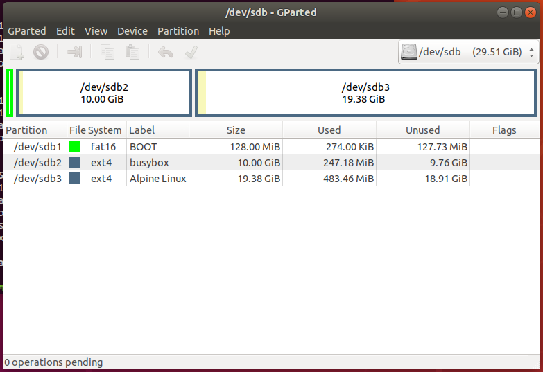

  1. SD 分区
    grub GParted 分区工具
    Ubuntu 打开 GParted 分区工具![f7e3a4a8-e395-4a50-85b8-e30182ac3b69.jpg][1],分成三区如下:
    grub GParted 分区工具
  2. 写入 U-boot

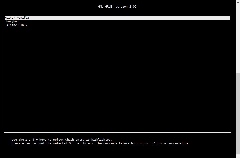

  3. 修改 boot/grup/grub.cfg, 添加启动项菜单:
set timeout=3
menuentry "Linux vanilla" {
linux /boot/vmlinuz-vanilla modules=loop,squashfs,sd-mod,usb-storage quiet
initrd /boot/initramfs-vanilla
menuentry "Busybox" {
linux /boot/zImage console=ttyS0,115200 panic=5 console=tty0 rootwait root=/dev/mmcblk0p2 earlyprintk rw
menuentry "Alpine Linux" {
linux /boot/zImage console=ttyS0,115200 panic=5 console=tty0 rootwait root=/dev/mmcblk0p3 earlyprintk rw

这是通过串口选择要进入的系统吧?

是的,在 boot 按键进入 grub 菜单。。
U-Boot SPL 2019.10-ge71ae959-dirty (Dec 10 2019 - 19:15:16 +0000)
DRAM: 64 MiB
Trying to boot from MMC1
U-Boot 2019.10-ge71ae959-dirty (Dec 10 2019 - 19:15:16 +0000) Allwinner Technology
Model: Lichee Pi Zero
DRAM:  64 MiB
MMC:   mmc@01c0f000: 0
Loading Environment from FAT... *** Warning - bad CRC, using default environment
In:    serial@01c28000
Out:   serial@01c28000
Err:   serial@01c28000
Net:   No ethernet found.
starting USB...
No working controllers found
switch to partitions #0, OK
mmc0 is current device
Scanning mmc 0:1...
Found EFI removable media binary efi/boot/bootarm.efi
libfdt fdt_check_header(): FDT_ERR_BADMAGIC
Scanning disk mmc@01c0f000.blk...
Found 4 disks
BootOrder not defined
EFI boot manager: Cannot load any image
311296 bytes read in 31 ms (9.6 MiB/s)
Welcome to GRUB!
error: no such device: alpine-uboot 3.10.3 armv7.
                                                        GNU GRUB  version 2.02
 │ Linux vanilla                                                                                                                    │
 │ busybox                                                                                                                          │
 │*Alpine Linux                                                                                                                     │
      Use the ▲ and ▼ keys to select which entry is highlighted.
      Press enter to boot the selected OS, `e' to edit the commands before booting or `c' for a command-line.
