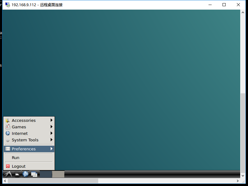

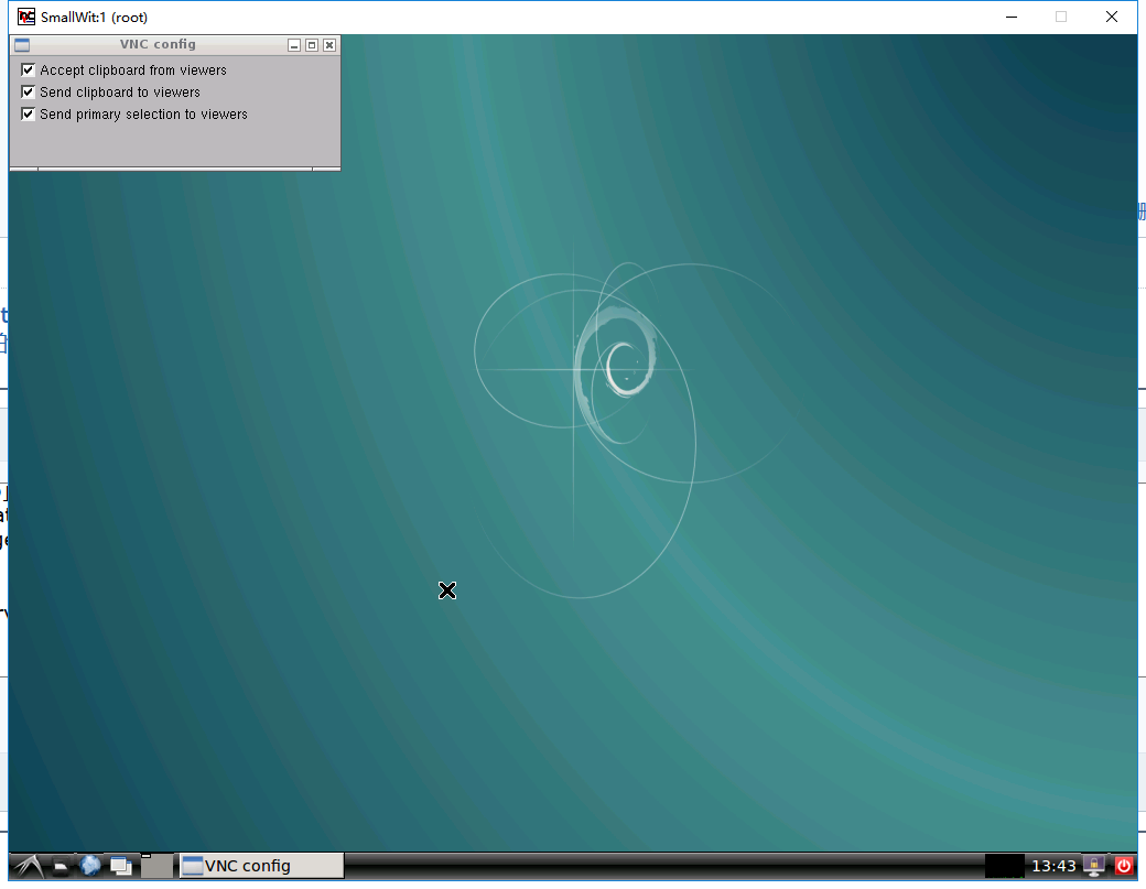

店主给的固件已经安装好了 vncserver, 但是我运行之后, vncviewer连上去之后, 什么窗口都没有:
楼主 #7 2019-11-24 22:01:10
并夕夕
注册时间: 2019-11-24
已发帖子: 32
积分: 32
Re: 今天终于收到了小智的S3开发板, 烧了店主给的debian8固件, 可以wifi联网, 也可以用apt-get更新固件,但是有一个幸福的烦恼
修改 ~/.vnc/xstartup 文件, 添加下面粗体字一行
#!/bin/sh
Uncomment the following two lines for normal desktop:
unset SESSION_MANAGER
exec /etc/X11/xinit/xinitrc
[ -x /etc/vnc/xstartup ] && exec /etc/vnc/xstartup
[ -r $HOME/.Xresources ] && xrdb $HOME/.Xresources
xsetroot -solid grey
vncconfig -iconic &
startlxde &
x-terminal-emulator -geometry 80x24+10+10 -ls -title "$VNCDESKTOP Desktop" &
x-window-manager &
然后再运行 vncserver, 貌似没问题了:

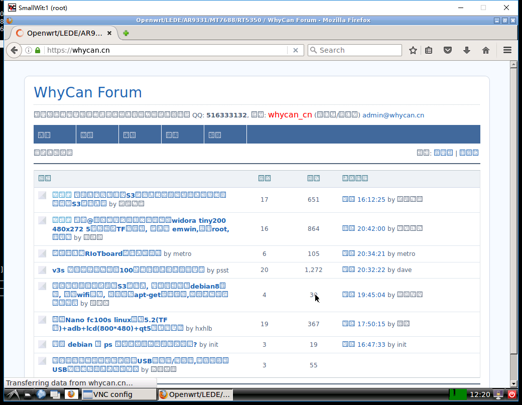

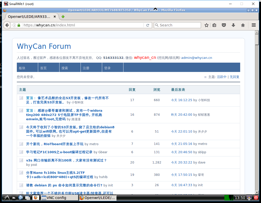

跑个 firefox 试一试:
哎哟, 居然汉字全部是方框框.
楼主 #8 2019-11-24 22:09:11
并夕夕
注册时间: 2019-11-24
已发帖子: 32
积分: 32
装上中文字体: apt-get install ttf-wqy-microhei ttf-wqy-zenhei
终于可以了.

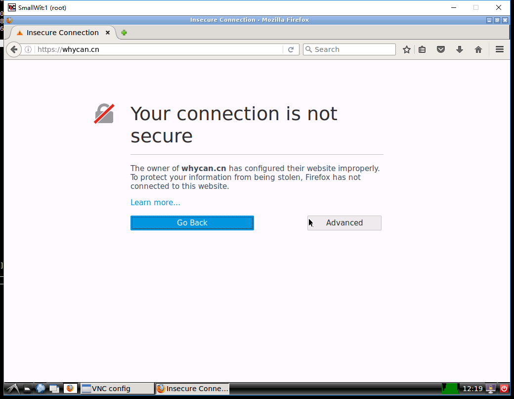

ntp时钟同步软件安装与使用:
apt-get install ntp -y
ntpdate
date
装上了 NTP 之后, 系统会自动同步服务器时间, 这样firefox 不会出现证书错误了:

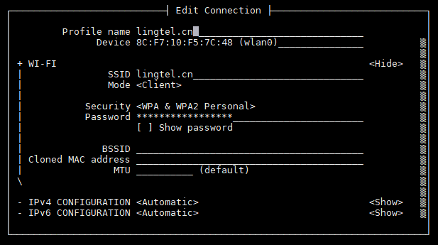

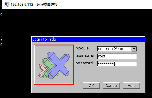

感谢楼主分享, 我也来试一试自动联网, 保存密码.
首先安装网络管理包: apt-get install network-manager -y
root@SmallWit:~# apt-get install network-manager -y
Reading package lists... Done
Building dependency tree
Reading state information... Done
network-manager is already the newest version.
0 upgraded, 0 newly installed, 0 to remove and 0 not upgraded.
然后执行:
systemctl restart NetworkManager.service
接着执行nmtui配网, 设置ssid和密码:
按上面激活后, 重启就可以保存wifi账号密码了,
感谢 @assert 大神的指点!

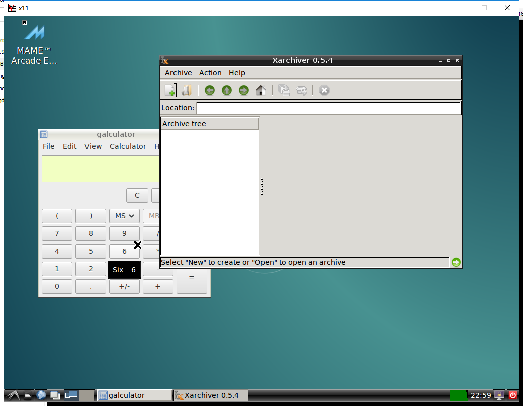

root@SmallWit:~# sudo apt install mame
The following extra packages will be installed:
  libasyncns0 libcaca0 libdirectfb-1.2-9 libflac8 libjson-c2 libogg0
  libportmidi0 libpulse0 libsdl-ttf2.0-0 libsdl1.2debian libsndfile1

居然这么多404错误:

47% [11 mame 2195 kB/13.6 MB 16%]                            87.9 kB/s 2min 11s[  310.235993] EXT4-fs (mmcblk0p2): error count since last fsck: 1
[  310.241954] EXT4-fs (mmcblk0p2): initial error at time 1574131551: ext4_find_entry:1451: inode 46140
[  310.251082] EXT4-fs (mmcblk0p2): last error at time 1574131551: ext4_find_entry:1451: inode 46140
47% [11 mame 2195 kB/13.6 MB 16%][  320.532399] brcmfmac: brcmf_p2p_send_action_frame: Unknown Frame: category 0xa, action 0x8
97% [11 mame 13.2 MB/13.6 MB 97%][  380.514009] brcmfmac: brcmf_p2p_send_action_frame: Unknown Frame: category 0xa, action 0x8
Fetched 21.8 MB in 2min 9s (169 kB/s)
E: Failed to fetch http://ftp.cn.debian.org/debian/pool/main/libv/libvorbis/libvorbis0a_1.3.4-2_armhf.deb  404  Not Found
E: Failed to fetch http://ftp.cn.debian.org/debian/pool/main/libv/libvorbis/libvorbisenc2_1.3.4-2_armhf.deb  404  Not Found
E: Unable to fetch some archives, maybe run apt-get update or try with --fix-missing?

太棒了, 原来可以不用另外安装 vncserver, 自带了 Xvnc, 所以 6楼/7楼的操作(手动运行vncserver命令)是多余的
https://whycan.cn/t_3287.html#p28402
只要修改 /etc/lightdm/lightdm.conf 最末即可:
[VNCServer]
enabled=true
command=Xvnc  -rfbauth /etc/vncpasswd
port=5900
width=1024
height=768
depth=24
记得先用命令手动设置一下密码, 保存到 /etc/vncpasswd:
vncpasswd /etc/vncpasswd
这样, 开机就可以自动运行 vnc 服务了, 不用再手动开启.
参考: https://wiki.archlinux.org/index.php/LightDM vnc 部分

root@SmallWit:~# sudo apt-get install xrdp
The following NEW packages will be installed:
  xrdp
0 upgraded, 1 newly installed, 0 to remove and 116 not upgraded.
Need to get 200 kB of archives.
After this operation, 1475 kB of additional disk space will be used.
Get:1 http://ftp.cn.debian.org/debian/ jessie/main xrdp armhf 0.6.1-2 [200 kB]
Fetched 200 kB in 1s (166 kB/s)
Selecting previously unselected package xrdp.
dpkg: warning: files list file for package 'libgomp1:armhf' missing; assuming package has no files currently installed
dpkg: warning: files list file for package 'libatomic1:armhf' missing; assuming package has no files currently installed
dpkg: warning: files list file for package 'libpython-dev:armhf' missing; assuming package has no files currently installed
dpkg: warning: files list file for package 'libubsan0:armhf' missing; assuming package has no files currently installed
dpkg: warning: files list file for package 'linux-libc-dev:armhf' missing; assuming package has no files currently installed
dpkg: warning: files list file for package 'libpython-stdlib:armhf' missing; assuming package has no files currently installed
dpkg: warning: files list file for package 'libasan1:armhf' missing; assuming package has no files currently installed
dpkg: warning: files list file for package 'libpython2.7:armhf' missing; assuming package has no files currently installed
dpkg: warning: files list file for package 'libgcc-4.9-dev:armhf' missing; assuming package has no files currently installed
dpkg: warning: files list file for package 'libsqlite3-0:armhf' missing; assuming package has no files currently installed
dpkg: warning: files list file for package 'libexpat1-dev:armhf' missing; assuming package has no files currently installed
dpkg: warning: files list file for package 'libpython2.7-dev:armhf' missing; assuming package has no files currently installed
dpkg: warning: files list file for package 'libpython2.7-minimal:armhf' missing; assuming package has no files currently installed
dpkg: warning: files list file for package 'libc6-dev:armhf' missing; assuming package has no files currently installed
dpkg: warning: files list file for package 'libapt-pkg4.12:armhf' missing; assuming package has no files currently installed
dpkg: warning: files list file for package 'libusb-0.1-4:armhf' missing; assuming package has no files currently installed
dpkg: warning: files list file for package 'libpython2.7-stdlib:armhf' missing; assuming package has no files currently installed
dpkg: warning: files list file for package 'libpcap0.8:armhf' missing; assuming package has no files currently installed
(Reading database ... 43257 files and directories currently installed.)
Preparing to unpack .../xrdp_0.6.1-2_armhf.deb ...
Unpacking xrdp (0.6.1-2) ...
Processing triggers for systemd (215-17+deb8u6) ...
Processing triggers for man-db (2.7.0.2-5) ...
Setting up xrdp (0.6.1-2) ...
insserv: warning: script 'wifi.sh' missing LSB tags and overrides
[ 3555.749462] brcmfmac: brcmf_p2p_send_action_frame: Unknown Frame: category 0xa, action 0x8
root@SmallWit:~#
root@SmallWit:~#
root@SmallWit:~#
root@SmallWit:~# service xrdp restart
root@SmallWit:~#
运行安装并启动xrdp服务:
sudo apt-get install xrdp -y
完全OK!
