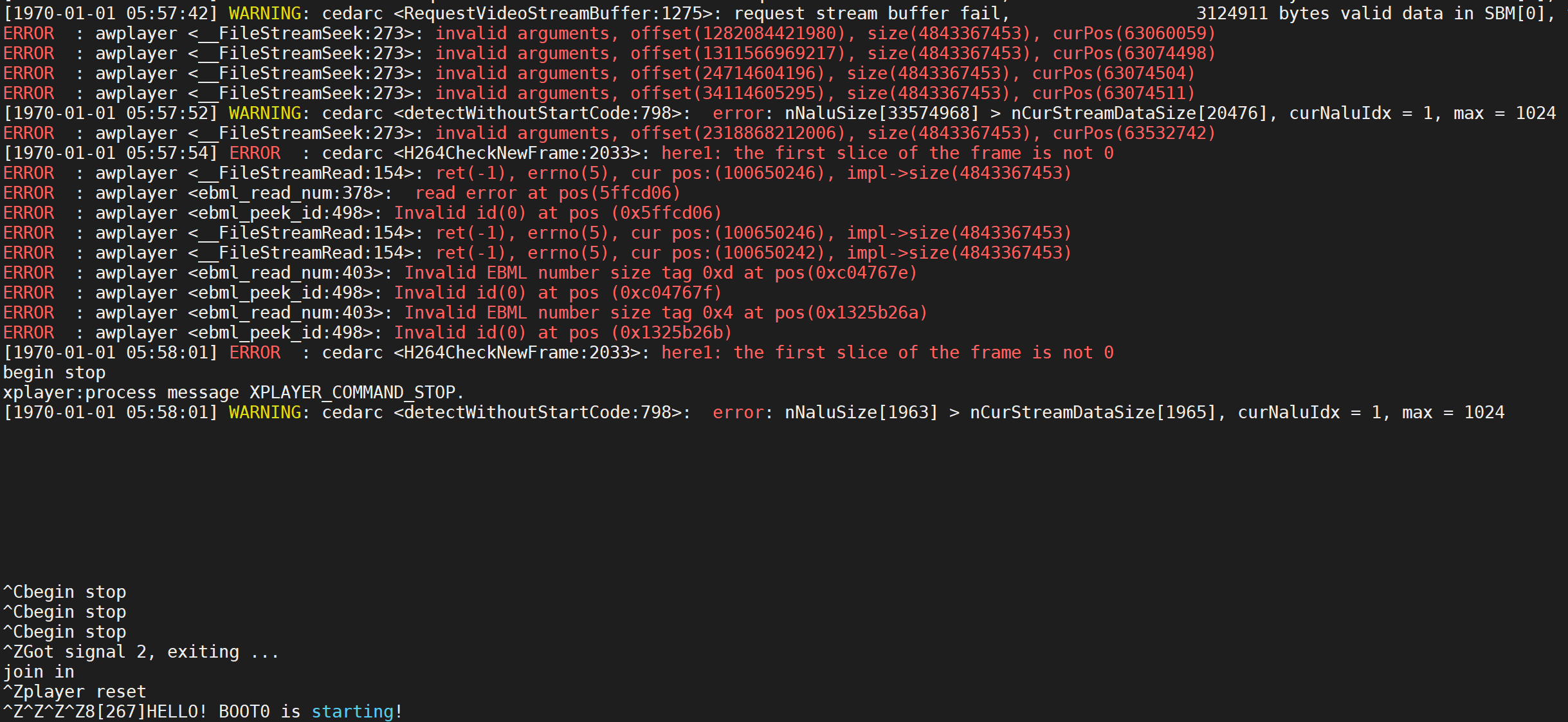

T113 tplayerdemo 播放视频,放着放着就挂了
Clicked item content: "/mnt/exUDISK/x.mp4"
xplayer:process message XPLAYER_COMMAND_STOP.
ERROR  : audioDecItf <handleStop:1109>: invalid stop operation, already in stopped status.
join in
xplayer:process message XPLAYER_COMMAND_RESET.
ERROR  : awplayer <PlayerStop:994>: invalid stop operation, player already in stopped status.
player reset
player destroy

xplayer:process message XPLAYER_COMMAND_SET_SUBCTRL.
xplayer:process message XPLAYER_COMMAND_SET_DI.
xplayer:process message XPLAYER_COMMAND_SET_SOURCE.
xplayer:process message XPLAYER_COMMAND_PREPARE.
ERROR  : CdxFlvParser.c <__CdxFlvParserProbe:4030>: FlvProbe failed.
ERROR  : CdxAviParser <__CdxAviParserProbe:1251>: AviProbe failed.
warning: unknown callback from Tinaplayer.
[1970-01-01 04:03:27] INFO   : cedarc <log_set_level:43>: Set log level to 5 from /vendor/etc/cedarc.conf
[1970-01-01 04:03:27] ERROR  : cedarc <DebugCheckConfig:302>: now cedarc log level:5
setDataSource end
*****tplayer:video width = 1920,height = 1080
TPLAYER_NOTIFY_PREPARED,has prepared.
prepare
prepared ok
xplayer:process message XPLAYER_COMMAND_START.
(Allwinner Audio Middle Layer),line(971) : Create Decoder!!=====
(Allwinner Audio Middle Layer),line(603) : AudioDec_Installaudiolib ok
(Allwinner Audio Middle Layer),line(606) : audio decoder init start ...
(AllwinnerAlibs),line(50) :
>>>>>>>>>>>>>>>>>>>>>>>>>>>>>>> Audio <<<<<<<<<<<<<<<<<<<<<<<<<<<<<<<
tag   : audiocodec-v1.2
branch: new
commit: 3ba65962c01cbf1280ddda19d843009b6ef8ce85
date  : Tue Jan 8 16:25:27 2019 +0800
(AllwinnerAlibs),line(700) : ----Loading so success!
(AllwinnerAlibs),line(902) : *************pAudioStreamInfo start******************
(AllwinnerAlibs),line(903) : eCodecFormat         :id(4), name(aac low-complexy)
(AllwinnerAlibs),line(904) : eSubCodecFormat      :0
(AllwinnerAlibs),line(905) : nChannelNum          :6
(AllwinnerAlibs),line(906) : nBitsPerSample       :16
(AllwinnerAlibs),line(907) : nSampleRate          :48000
(AllwinnerAlibs),line(908) : nAvgBitrate          :0
(AllwinnerAlibs),line(909) : nMaxBitRate          :0
(AllwinnerAlibs),line(910) : nFileSize            :0
(AllwinnerAlibs),line(911) : eAudioBitstreamSource:0
(AllwinnerAlibs),line(912) : eDataEncodeType      :1
(AllwinnerAlibs),line(913) : nCodecSpecificDataLen:2
(AllwinnerAlibs),line(914) : pCodecSpecificData   :0xb14685b8
(AllwinnerAlibs),line(915) : nFlags               :0
(AllwinnerAlibs),line(916) : nBlockAlign          :0
(AllwinnerAlibs),line(917) : *************pAudioStreamInfo end  ******************
(AAC Decoder),line(36) : init successs...
(Allwinner Audio Middle Layer),line(614) : AUDIO DECODE INIT OK...0
==> duration = 5672768
****player(0x12b26b8): first audio pts = 0*****
ERROR  : awplayer <__LayerQueueBuffer:934>: *** picNode is full when queue buffer
*****tplayer:video decoded width = 1920,height = 1080
*****tplayer:video width = 3840,height = 2160
****player(0x12b26b8): first video pts = 0*****
ERROR  : awplayer <ProcessVideoSync:1317>: need to drop this frame
[1970-01-01 04:03:27] ERROR  : fbm.c <FbmReturnPicture:1043>: invalid frame status, a picture being returned,                 but bUsedByRender=0, bInValidPictureQueue=1, bAlreadyDisplayed=0.
[1970-01-01 04:03:27] ERROR  : fbm.c <FbmReturnPicture:1044>: **picture[0x12e7fd0],id[8]
[1970-01-01 04:03:27] WARNING: cedarc <ReturnPicture:1700>: FbmReturnPicture return fail,            it means the picture being returned it not one of this FBM.
[1970-01-01 04:08:17] WARNING: cedarc <RequestVideoStreamBuffer:1275>: request stream buffer fail,                  3996338 bytes valid data in SBM[0], total buffer size is 4194304 bytes.
[1970-01-01 04:08:47] WARNING: cedarc <RequestVideoStreamBuffer:1275>: request stream buffer fail,                  4145339 bytes valid data in SBM[0], total buffer size is 4194304 bytes.
[1970-01-01 04:08:47] WARNING: cedarc <RequestVideoStreamBuffer:1275>: request stream buffer fail,                  4069633 bytes valid data in SBM[0], total buffer size is 4194304 bytes.
[1970-01-01 04:08:47] WARNING: cedarc <RequestVideoStreamBuffer:1275>: request stream buffer fail,                  4071548 bytes valid data in SBM[0], total buffer size is 4194304 bytes.
[1970-01-01 04:08:47] WARNING: cedarc <RequestVideoStreamBuffer:1275>: request stream buffer fail,                  4169634 bytes valid data in SBM[0], total buffer size is 4194304 bytes.
[1970-01-01 04:08:47] WARNING: cedarc <RequestVideoStreamBuffer:1275>: request stream buffer fail,                  4148802 bytes valid data in SBM[0], total buffer size is 4194304 bytes.
[1970-01-01 04:08:48] WARNING: cedarc <RequestVideoStreamBuffer:1275>: request stream buffer fail,                  4103437 bytes valid data in SBM[0], total buffer size is 4194304 bytes.
[1970-01-01 04:08:48] WARNING: cedarc <RequestVideoStreamBuffer:1275>: request stream buffer fail,                  4136769 bytes valid data in SBM[0], total buffer size is 4194304 bytes.
[1970-01-01 04:08:48] WARNING: cedarc <RequestVideoStreamBuffer:1275>: request stream buffer fail,                  4126547 bytes valid data in SBM[0], total buffer size is 4194304 bytes.
[1970-01-01 04:08:48] WARNING: cedarc <RequestVideoStreamBuffer:1275>: request stream buffer fail,                  4164039 bytes valid data in SBM[0], total buffer size is 4194304 bytes.
[1970-01-01 04:08:48] WARNING: cedarc <RequestVideoStreamBuffer:1275>: request stream buffer fail,                  4155263 bytes valid data in SBM[0], total buffer size is 4194304 bytes.
[1970-01-01 04:08:49] WARNING: cedarc <RequestVideoStreamBuffer:1275>: request stream buffer fail,                  4165867 bytes valid data in SBM[0], total buffer size is 4194304 bytes.
[1970-01-01 04:08:49] WARNING: cedarc <RequestVideoStreamBuffer:1275>: request stream buffer fail,                  4172182 bytes valid data in SBM[0], total buffer size is 4194304 bytes.
[1970-01-01 04:08:49] WARNING: cedarc <RequestVideoStreamBuffer:1275>: request stream buffer fail,                  4137545 bytes valid data in SBM[0], total buffer size is 4194304 bytes.
[1970-01-01 04:13:49] WARNING: cedarc <RequestVideoStreamBuffer:1275>: request stream buffer fail,                  4184295 bytes valid data in SBM[0], total buffer size is 4194304 bytes.
[1970-01-01 04:18:06] WARNING: cedarc <RequestVideoStreamBuffer:1275>: request stream buffer fail,                  4141262 bytes valid data in SBM[0], total buffer size is 4194304 bytes.
[1970-01-01 04:18:06] WARNING: cedarc <RequestVideoStreamBuffer:1275>: request stream buffer fail,                  4153905 bytes valid data in SBM[0], total buffer size is 4194304 bytes.
[1970-01-01 04:18:06] WARNING: cedarc <RequestVideoStreamBuffer:1275>: request stream buffer fail,                  3893169 bytes valid data in SBM[0], total buffer size is 4194304 bytes.
[1970-01-01 04:18:08] WARNING: cedarc <RequestVideoStreamBuffer:1275>: request stream buffer fail,                  4136925 bytes valid data in SBM[0], total buffer size is 4194304 bytes.
[1970-01-01 04:18:08] WARNING: cedarc <RequestVideoStreamBuffer:1275>: request stream buffer fail,                  3972767 bytes valid data in SBM[0], total buffer size is 4194304 bytes.
[1970-01-01 04:18:08] WARNING: cedarc <RequestVideoStreamBuffer:1275>: request stream buffer fail,                  4031852 bytes valid data in SBM[0], total buffer size is 4194304 bytes.
[1970-01-01 04:18:09] WARNING: cedarc <RequestVideoStreamBuffer:1275>: request stream buffer fail,                  4015077 bytes valid data in SBM[0], total buffer size is 4194304 bytes.
[1970-01-01 04:18:09] WARNING: cedarc <RequestVideoStreamBuffer:1275>: request stream buffer fail,                  3979862 bytes valid data in SBM[0], total buffer size is 4194304 bytes.
[1970-01-01 04:18:09] WARNING: cedarc <RequestVideoStreamBuffer:1275>: request stream buffer fail,                  4143795 bytes valid data in SBM[0], total buffer size is 4194304 bytes.
[1970-01-01 04:18:09] WARNING: cedarc <RequestVideoStreamBuffer:1275>: request stream buffer fail,                  4095365 bytes valid data in SBM[0], total buffer size is 4194304 bytes.
[1970-01-01 04:18:09] WARNING: cedarc <RequestVideoStreamBuffer:1275>: request stream buffer fail,                  3997885 bytes valid data in SBM[0], total buffer size is 4194304 bytes.
[1970-01-01 04:18:10] WARNING: cedarc <RequestVideoStreamBuffer:1275>: request stream buffer fail,                  4164078 bytes valid data in SBM[0], total buffer size is 4194304 bytes.
[1970-01-01 04:18:10] WARNING: cedarc <RequestVideoStreamBuffer:1275>: request stream buffer fail,                  4084911 bytes valid data in SBM[0], total buffer size is 4194304 bytes.
[1970-01-01 04:18:10] WARNING: cedarc <RequestVideoStreamBuffer:1275>: request stream buffer fail,                  4043369 bytes valid data in SBM[0], total buffer size is 4194304 bytes.
[1970-01-01 04:18:10] WARNING: cedarc <RequestVideoStreamBuffer:1275>: request stream buffer fail,                  4172036 bytes valid data in SBM[0], total buffer size is 4194304 bytes.
[1970-01-01 04:18:10] WARNING: cedarc <RequestVideoStreamBuffer:1275>: request stream buffer fail,                  4110123 bytes valid data in SBM[0], total buffer size is 4194304 bytes.
[1970-01-01 04:18:11] WARNING: cedarc <RequestVideoStreamBuffer:1275>: request stream buffer fail,                  4105002 bytes valid data in SBM[0], total buffer size is 4194304 bytes.
[1970-01-01 04:18:35] WARNING: cedarc <RequestVideoStreamBuffer:1275>: request stream buffer fail,                  4177814 bytes valid data in SBM[0], total buffer size is 4194304 bytes.
[1970-01-01 04:18:35] WARNING: cedarc <RequestVideoStreamBuffer:1275>: request stream buffer fail,                  4072148 bytes valid data in SBM[0], total buffer size is 4194304 bytes.
[1970-01-01 04:18:35] WARNING: cedarc <RequestVideoStreamBuffer:1275>: request stream buffer fail,                  4117727 bytes valid data in SBM[0], total buffer size is 4194304 bytes.
[1970-01-01 04:18:35] WARNING: cedarc <RequestVideoStreamBuffer:1275>: request stream buffer fail,                  4076312 bytes valid data in SBM[0], total buffer size is 4194304 bytes.
[1970-01-01 04:18:35] WARNING: cedarc <RequestVideoStreamBuffer:1275>: request stream buffer fail,                  4182423 bytes valid data in SBM[0], total buffer size is 4194304 bytes.
[1970-01-01 04:18:36] WARNING: cedarc <RequestVideoStreamBuffer:1275>: request stream buffer fail,                  4123271 bytes valid data in SBM[0], total buffer size is 4194304 bytes.
[1970-01-01 04:18:36] WARNING: cedarc <RequestVideoStreamBuffer:1275>: request stream buffer fail,                  4024710 bytes valid data in SBM[0], total buffer size is 4194304 bytes.
[1970-01-01 04:18:36] WARNING: cedarc <RequestVideoStreamBuffer:1275>: request stream buffer fail,                  4116039 bytes valid data in SBM[0], total buffer size is 4194304 bytes.
[1970-01-01 04:18:36] WARNING: cedarc <RequestVideoStreamBuffer:1275>: request stream buffer fail,                  4063401 bytes valid data in SBM[0], total buffer size is 4194304 bytes.
[1970-01-01 04:18:36] WARNING: cedarc <RequestVideoStreamBuffer:1275>: request stream buffer fail,                  4030467 bytes valid data in SBM[0], total buffer size is 4194304 bytes.
[1970-01-01 04:18:37] WARNING: cedarc <RequestVideoStreamBuffer:1275>: request stream buffer fail,                  4184579 bytes valid data in SBM[0], total buffer size is 4194304 bytes.
[1970-01-01 04:18:37] WARNING: cedarc <RequestVideoStreamBuffer:1275>: request stream buffer fail,                  4121034 bytes valid data in SBM[0], total buffer size is 4194304 bytes.
[1970-01-01 04:18:37] WARNING: cedarc <RequestVideoStreamBuffer:1275>: request stream buffer fail,                  4082141 bytes valid data in SBM[0], total buffer size is 4194304 bytes.
[1970-01-01 04:18:37] WARNING: cedarc <RequestVideoStreamBuffer:1275>: request stream buffer fail,                  4070249 bytes valid data in SBM[0], total buffer size is 4194304 bytes.
[1970-01-01 04:18:38] WARNING: cedarc <RequestVideoStreamBuffer:1275>: request stream buffer fail,                  4158564 bytes valid data in SBM[0], total buffer size is 4194304 bytes.
[1970-01-01 04:18:38] WARNING: cedarc <RequestVideoStreamBuffer:1275>: request stream buffer fail,                  4182722 bytes valid data in SBM[0], total buffer size is 4194304 bytes.
[1970-01-01 04:18:38] WARNING: cedarc <RequestVideoStreamBuffer:1275>: request stream buffer fail,                  4182332 bytes valid data in SBM[0], total buffer size is 4194304 bytes.
[1970-01-01 04:18:38] WARNING: cedarc <RequestVideoStreamBuffer:1275>: request stream buffer fail,                  4180467 bytes valid data in SBM[0], total buffer size is 4194304 bytes.
[1970-01-01 04:19:25] WARNING: cedarc <RequestVideoStreamBuffer:1275>: request stream buffer fail,                  4069291 bytes valid data in SBM[0], total buffer size is 4194304 bytes.
[1970-01-01 04:19:35] WARNING: cedarc <RequestVideoStreamBuffer:1275>: request stream buffer fail,                  4168666 bytes valid data in SBM[0], total buffer size is 4194304 bytes.
[1970-01-01 04:19:35] WARNING: cedarc <RequestVideoStreamBuffer:1275>: request stream buffer fail,                  4036667 bytes valid data in SBM[0], total buffer size is 4194304 bytes.
[1970-01-01 04:19:36] WARNING: cedarc <RequestVideoStreamBuffer:1275>: request stream buffer fail,                  4151872 bytes valid data in SBM[0], total buffer size is 4194304 bytes.
[1970-01-01 04:19:36] WARNING: cedarc <RequestVideoStreamBuffer:1275>: request stream buffer fail,                  4183623 bytes valid data in SBM[0], total buffer size is 4194304 bytes.
[1970-01-01 04:19:36] WARNING: cedarc <RequestVideoStreamBuffer:1275>: request stream buffer fail,                  4180548 bytes valid data in SBM[0], total buffer size is 4194304 bytes.
[1970-01-01 04:19:36] WARNING: cedarc <RequestVideoStreamBuffer:1275>: request stream buffer fail,                  4150417 bytes valid data in SBM[0], total buffer size is 4194304 bytes.
[1970-01-01 04:19:36] WARNING: cedarc <RequestVideoStreamBuffer:1275>: request stream buffer fail,                  4176078 bytes valid data in SBM[0], total buffer size is 4194304 bytes.
[1970-01-01 04:19:37] WARNING: cedarc <RequestVideoStreamBuffer:1275>: request stream buffer fail,                  4163902 bytes valid data in SBM[0], total buffer size is 4194304 bytes.
[1970-01-01 04:19:37] WARNING: cedarc <RequestVideoStreamBuffer:1275>: request stream buffer fail,                  4180308 bytes valid data in SBM[0], total buffer size is 4194304 bytes.
[1970-01-01 04:19:37] WARNING: cedarc <RequestVideoStreamBuffer:1275>: request stream buffer fail,                  4073603 bytes valid data in SBM[0], total buffer size is 4194304 bytes.
[1970-01-01 04:23:12] WARNING: cedarc <RequestVideoStreamBuffer:1275>: request stream buffer fail,                  4139320 bytes valid data in SBM[0], total buffer size is 4194304 bytes.
[1970-01-01 04:23:12] WARNING: cedarc <RequestVideoStreamBuffer:1275>: request stream buffer fail,                  4120620 bytes valid data in SBM[0], total buffer size is 4194304 bytes.
[1970-01-01 04:23:12] WARNING: cedarc <RequestVideoStreamBuffer:1275>: request stream buffer fail,                  4160342 bytes valid data in SBM[0], total buffer size is 4194304 bytes.
[1970-01-01 04:23:12] WARNING: cedarc <RequestVideoStreamBuffer:1275>: request stream buffer fail,                  4150360 bytes valid data in SBM[0], total buffer size is 4194304 bytes.
[1970-01-01 04:23:12] WARNING: cedarc <RequestVideoStreamBuffer:1275>: request stream buffer fail,                  4123361 bytes valid data in SBM[0], total buffer size is 4194304 bytes.
[1970-01-01 04:23:13] WARNING: cedarc <RequestVideoStreamBuffer:1275>: request stream buffer fail,                  4126479 bytes valid data in SBM[0], total buffer size is 4194304 bytes.
[1970-01-01 04:23:13] WARNING: cedarc <RequestVideoStreamBuffer:1275>: request stream buffer fail,                  4175936 bytes valid data in SBM[0], total buffer size is 4194304 bytes.
[1970-01-01 04:23:13] WARNING: cedarc <RequestVideoStreamBuffer:1275>: request stream buffer fail,                  4151131 bytes valid data in SBM[0], total buffer size is 4194304 bytes.
[1970-01-01 04:23:13] WARNING: cedarc <RequestVideoStreamBuffer:1275>: request stream buffer fail,                  4161345 bytes valid data in SBM[0], total buffer size is 4194304 bytes.
[1970-01-01 04:23:13] WARNING: cedarc <RequestVideoStreamBuffer:1275>: request stream buffer fail,                  4185877 bytes valid data in SBM[0], total buffer size is 4194304 bytes.
[1970-01-01 04:23:14] WARNING: cedarc <RequestVideoStreamBuffer:1275>: request stream buffer fail,                  4179553 bytes valid data in SBM[0], total buffer size is 4194304 bytes.
[1970-01-01 04:23:16] WARNING: cedarc <RequestVideoStreamBuffer:1275>: request stream buffer fail,                  4172125 bytes valid data in SBM[0], total buffer size is 4194304 bytes.
[1970-01-01 04:23:16] WARNING: cedarc <RequestVideoStreamBuffer:1275>: request stream buffer fail,                  4174694 bytes valid data in SBM[0], total buffer size is 4194304 bytes.
[1970-01-01 04:23:17] WARNING: cedarc <RequestVideoStreamBuffer:1275>: request stream buffer fail,                  4144040 bytes valid data in SBM[0], total buffer size is 4194304 bytes.
[1970-01-01 04:23:17] WARNING: cedarc <RequestVideoStreamBuffer:1275>: request stream buffer fail,                  4116278 bytes valid data in SBM[0], total buffer size is 4194304 bytes.
[1970-01-01 04:23:17] WARNING: cedarc <RequestVideoStreamBuffer:1275>: request stream buffer fail,                  4159306 bytes valid data in SBM[0], total buffer size is 4194304 bytes.
[1970-01-01 04:23:17] WARNING: cedarc <RequestVideoStreamBuffer:1275>: request stream buffer fail,                  4178812 bytes valid data in SBM[0], total buffer size is 4194304 bytes.
[1970-01-01 04:23:18] WARNING: cedarc <RequestVideoStreamBuffer:1275>: request stream buffer fail,                  4116375 bytes valid data in SBM[0], total buffer size is 4194304 bytes.
[1970-01-01 04:23:18] WARNING: cedarc <RequestVideoStreamBuffer:1275>: request stream buffer fail,                  4154515 bytes valid data in SBM[0], total buffer size is 4194304 bytes.
[1970-01-01 04:23:18] WARNING: cedarc <RequestVideoStreamBuffer:1275>: request stream buffer fail,                  4123733 bytes valid data in SBM[0], total buffer size is 4194304 bytes.
[1970-01-01 04:23:18] WARNING: cedarc <RequestVideoStreamBuffer:1275>: request stream buffer fail,                  4168041 bytes valid data in SBM[0], total buffer size is 4194304 bytes.
[1970-01-01 04:23:18] WARNING: cedarc <RequestVideoStreamBuffer:1275>: request stream buffer fail,                  4143166 bytes valid data in SBM[0], total buffer size is 4194304 bytes.
[1970-01-01 04:23:19] WARNING: cedarc <RequestVideoStreamBuffer:1275>: request stream buffer fail,                  4160647 bytes valid data in SBM[0], total buffer size is 4194304 bytes.
[1970-01-01 04:23:19] WARNING: cedarc <RequestVideoStreamBuffer:1275>: request stream buffer fail,                  4163891 bytes valid data in SBM[0], total buffer size is 4194304 bytes.
[1970-01-01 04:23:19] WARNING: cedarc <RequestVideoStreamBuffer:1275>: request stream buffer fail,                  4145820 bytes valid data in SBM[0], total buffer size is 4194304 bytes.
[1970-01-01 04:23:19] WARNING: cedarc <RequestVideoStreamBuffer:1275>: request stream buffer fail,                  4173372 bytes valid data in SBM[0], total buffer size is 4194304 bytes.
[1970-01-01 04:23:19] WARNING: cedarc <RequestVideoStreamBuffer:1275>: request stream buffer fail,                  4181735 bytes valid data in SBM[0], total buffer size is 4194304 bytes.
[1970-01-01 04:23:20] WARNING: cedarc <RequestVideoStreamBuffer:1275>: request stream buffer fail,                  4120385 bytes valid data in SBM[0], total buffer size is 4194304 bytes.
[1970-01-01 04:24:20] WARNING: cedarc <RequestVideoStreamBuffer:1275>: request stream buffer fail,                  4185324 bytes valid data in SBM[0], total buffer size is 4194304 bytes.
[1970-01-01 04:24:20] WARNING: cedarc <RequestVideoStreamBuffer:1275>: request stream buffer fail,                  4135893 bytes valid data in SBM[0], total buffer size is 4194304 bytes.
[1970-01-01 04:24:20] WARNING: cedarc <RequestVideoStreamBuffer:1275>: request stream buffer fail,                  4144512 bytes valid data in SBM[0], total buffer size is 4194304 bytes.
[1970-01-01 04:24:20] WARNING: cedarc <RequestVideoStreamBuffer:1275>: request stream buffer fail,                  4105365 bytes valid data in SBM[0], total buffer size is 4194304 bytes.
[1970-01-01 04:24:20] WARNING: cedarc <RequestVideoStreamBuffer:1275>: request stream buffer fail,                  4148214 bytes valid data in SBM[0], total buffer size is 4194304 bytes.
[1970-01-01 04:24:21] WARNING: cedarc <RequestVideoStreamBuffer:1275>: request stream buffer fail,                  4160956 bytes valid data in SBM[0], total buffer size is 4194304 bytes.
[1970-01-01 04:24:21] WARNING: cedarc <RequestVideoStreamBuffer:1275>: request stream buffer fail,                  4147841 bytes valid data in SBM[0], total buffer size is 4194304 bytes.
[1970-01-01 04:24:21] WARNING: cedarc <RequestVideoStreamBuffer:1275>: request stream buffer fail,                  4160612 bytes valid data in SBM[0], total buffer size is 4194304 bytes.
[1970-01-01 04:24:21] WARNING: cedarc <RequestVideoStreamBuffer:1275>: request stream buffer fail,                  4179447 bytes valid data in SBM[0], total buffer size is 4194304 bytes.
[1970-01-01 04:24:22] WARNING: cedarc <RequestVideoStreamBuffer:1275>: request stream buffer fail,                  4147463 bytes valid data in SBM[0], total buffer size is 4194304 bytes.
[1970-01-01 04:24:22] WARNING: cedarc <RequestVideoStreamBuffer:1275>: request stream buffer fail,                  4154625 bytes valid data in SBM[0], total buffer size is 4194304 bytes.
[1970-01-01 04:24:22] WARNING: cedarc <RequestVideoStreamBuffer:1275>: request stream buffer fail,                  4133210 bytes valid data in SBM[0], total buffer size is 4194304 bytes.
[1970-01-01 04:24:22] WARNING: cedarc <RequestVideoStreamBuffer:1275>: request stream buffer fail,                  4124449 bytes valid data in SBM[0], total buffer size is 4194304 bytes.
[1970-01-01 04:24:22] WARNING: cedarc <RequestVideoStreamBuffer:1275>: request stream buffer fail,                  4132555 bytes valid data in SBM[0], total buffer size is 4194304 bytes.
[1970-01-01 04:24:23] WARNING: cedarc <RequestVideoStreamBuffer:1275>: request stream buffer fail,                  4143987 bytes valid data in SBM[0], total buffer size is 4194304 bytes.
[1970-01-01 04:24:23] WARNING: cedarc <RequestVideoStreamBuffer:1275>: request stream buffer fail,                  4169446 bytes valid data in SBM[0], total buffer size is 4194304 bytes.
[1970-01-01 04:24:23] WARNING: cedarc <RequestVideoStreamBuffer:1275>: request stream buffer fail,                  4165256 bytes valid data in SBM[0], total buffer size is 4194304 bytes.
****player(0x12b26b8): first video pts = 5145015000*****
****player(0x12b26b8): first audio pts = 5145024000*****
ERROR  : awplayer <ebml_read_num:378>:  read error at pos(10fb5fcae)
ERROR  : awplayer <ebml_peek_id:498>: Invalid id(0) at pos (0x10fb5fcae)
(AllwinnerAlibs),line(1474) : ad_cedar seek sync ......nSeekTime:0
Clicked item content: "/mnt/exUDISK/film/3.Ice.Age.Dawn.of.the.Dinosaurs.2009.BD1080P.X264.AAC.Mandarin&English.CHS-ENG.mp4"
(AAC Decoder),line(44) : exit successs...
(AllwinnerAlibs),line(750) : ----dlclose so success!
(Allwinner Audio Middle Layer),line(920) : destroy_ResampleInfo!!
(Allwinner Audio Resample),line(68) : Destroy_ResampleInfo...
join in
player reset
player destroy
>>>>>>>>>>>>>>>>>>>>>>>>>>>>>>> tina_multimedia <<<<<<<<<<<<<<<<<<<<<<<<<<<<<<<
tag   : tina3.5
branch: tina-dev
date  : Mon Jul 15 19:04:59 2019 +0800
Change-Id: I5f6c8a88d7b387a312b7744797a0d5f8ab07ee7a
xplayer:process message XPLAYER_COMMAND_SET_AUDIOSINK.
xplayer:process message XPLAYER_COMMAND_SET_SURFACE.
[1970-01-01 05:04:08] ERROR  : cedarc <DebugCheckConfig:302>: now cedarc log level:5
setDataSource end
*****tplayer:video width = 1920,height = 1036
prepare
prepared ok
branch: new
(AllwinnerAlibs),line(914) : pCodecSpecificData   :0xb16688d0
==> duration = 5643349
****player(0x12e6088): first audio pts = 0*****
*****tplayer:video decoded width = 1920,height = 1036
*****tplayer:video width = 3840,height = 2072
****player(0x12e6088): first video pts = 0*****
[1970-01-01 05:04:08] ERROR  : fbm.c <FbmReturnPicture:1043>: invalid frame status, a picture being returned,                 but bUsedByRender=0, bInValidPictureQueue=1, bAlreadyDisplayed=0.
[1970-01-01 05:04:08] ERROR  : fbm.c <FbmReturnPicture:1044>: **picture[0x12b45f8],id[8]
[1970-01-01 05:04:08] WARNING: cedarc <ReturnPicture:1700>: FbmReturnPicture return fail,            it means the picture being returned it not one of this FBM.
xplayer:process message XPLAYER_COMMAND_SEEK.
newValue=593231
(AllwinnerAlibs),line(1474) : ad_cedar seek sync ......nSeekTime:593231000
TPLAYER_NOTIFY_SEEK_COMPLETE>>>>info: seek ok.
****player(0x12e6088): first audio pts = 597440000*****
****player(0x12e6088): first video pts = 597430000*****
newValue=2503197
(AllwinnerAlibs),line(1474) : ad_cedar seek sync ......nSeekTime:2503197000
****player(0x12e6088): first audio pts = 2504341000*****
****player(0x12e6088): first video pts = 2504335000*****
[1970-01-01 05:04:13] WARNING: cedarc <RequestVideoStreamBuffer:1275>: request stream buffer fail,                  3121946 bytes valid data in SBM[0], total buffer size is 3145728 bytes.
[1970-01-01 05:04:14] WARNING: cedarc <RequestVideoStreamBuffer:1275>: request stream buffer fail,                  3079803 bytes valid data in SBM[0], total buffer size is 3145728 bytes.
[1970-01-01 05:04:14] WARNING: cedarc <RequestVideoStreamBuffer:1275>: request stream buffer fail,                  3086001 bytes valid data in SBM[0], total buffer size is 3145728 bytes.
[1970-01-01 05:04:14] WARNING: cedarc <RequestVideoStreamBuffer:1275>: request stream buffer fail,                  3089731 bytes valid data in SBM[0], total buffer size is 3145728 bytes.
[1970-01-01 05:04:14] WARNING: cedarc <RequestVideoStreamBuffer:1275>: request stream buffer fail,                  3072850 bytes valid data in SBM[0], total buffer size is 3145728 bytes.
[1970-01-01 05:04:14] WARNING: cedarc <RequestVideoStreamBuffer:1275>: request stream buffer fail,                  3085072 bytes valid data in SBM[0], total buffer size is 3145728 bytes.
[1970-01-01 05:04:15] WARNING: cedarc <RequestVideoStreamBuffer:1275>: request stream buffer fail,                  3064529 bytes valid data in SBM[0], total buffer size is 3145728 bytes.
[1970-01-01 05:04:27] WARNING: cedarc <RequestVideoStreamBuffer:1275>: request stream buffer fail,                  3047704 bytes valid data in SBM[0], total buffer size is 3145728 bytes.
[1970-01-01 05:04:28] WARNING: cedarc <RequestVideoStreamBuffer:1275>: request stream buffer fail,                  3135383 bytes valid data in SBM[0], total buffer size is 3145728 bytes.
[1970-01-01 05:04:34] WARNING: cedarc <RequestVideoStreamBuffer:1275>: request stream buffer fail,                  3133327 bytes valid data in SBM[0], total buffer size is 3145728 bytes.
[1970-01-01 05:04:35] WARNING: cedarc <RequestVideoStreamBuffer:1275>: request stream buffer fail,                  3078262 bytes valid data in SBM[0], total buffer size is 3145728 bytes.
[1970-01-01 05:04:35] WARNING: cedarc <RequestVideoStreamBuffer:1275>: request stream buffer fail,                  3090352 bytes valid data in SBM[0], total buffer size is 3145728 bytes.
[1970-01-01 05:04:35] WARNING: cedarc <RequestVideoStreamBuffer:1275>: request stream buffer fail,                  3119475 bytes valid data in SBM[0], total buffer size is 3145728 bytes.
[1970-01-01 05:04:35] WARNING: cedarc <RequestVideoStreamBuffer:1275>: request stream buffer fail,                  3129451 bytes valid data in SBM[0], total buffer size is 3145728 bytes.
[1970-01-01 05:04:35] WARNING: cedarc <RequestVideoStreamBuffer:1275>: request stream buffer fail,                  3108982 bytes valid data in SBM[0], total buffer size is 3145728 bytes.
[1970-01-01 05:04:36] WARNING: cedarc <RequestVideoStreamBuffer:1275>: request stream buffer fail,                  3100662 bytes valid data in SBM[0], total buffer size is 3145728 bytes.
[1970-01-01 05:04:36] WARNING: cedarc <RequestVideoStreamBuffer:1275>: request stream buffer fail,                  3064256 bytes valid data in SBM[0], total buffer size is 3145728 bytes.
[1970-01-01 05:04:36] WARNING: cedarc <RequestVideoStreamBuffer:1275>: request stream buffer fail,                  3126669 bytes valid data in SBM[0], total buffer size is 3145728 bytes.
[1970-01-01 05:04:36] WARNING: cedarc <RequestVideoStreamBuffer:1275>: request stream buffer fail,                  3102140 bytes valid data in SBM[0], total buffer size is 3145728 bytes.
[1970-01-01 05:04:36] WARNING: cedarc <RequestVideoStreamBuffer:1275>: request stream buffer fail,                  3069117 bytes valid data in SBM[0], total buffer size is 3145728 bytes.
[1970-01-01 05:04:37] WARNING: cedarc <RequestVideoStreamBuffer:1275>: request stream buffer fail,                  3134355 bytes valid data in SBM[0], total buffer size is 3145728 bytes.
[1970-01-01 05:04:37] WARNING: cedarc <RequestVideoStreamBuffer:1275>: request stream buffer fail,                  3092595 bytes valid data in SBM[0], total buffer size is 3145728 bytes.
[1970-01-01 05:04:37] WARNING: cedarc <RequestVideoStreamBuffer:1275>: request stream buffer fail,                  3094555 bytes valid data in SBM[0], total buffer size is 3145728 bytes.
[1970-01-01 05:04:37] WARNING: cedarc <RequestVideoStreamBuffer:1275>: request stream buffer fail,                  3133312 bytes valid data in SBM[0], total buffer size is 3145728 bytes.
[1970-01-01 05:04:37] WARNING: cedarc <RequestVideoStreamBuffer:1275>: request stream buffer fail,                  3098621 bytes valid data in SBM[0], total buffer size is 3145728 bytes.
[1970-01-01 05:04:38] WARNING: cedarc <RequestVideoStreamBuffer:1275>: request stream buffer fail,                  3092318 bytes valid data in SBM[0], total buffer size is 3145728 bytes.
[1970-01-01 05:04:38] WARNING: cedarc <RequestVideoStreamBuffer:1275>: request stream buffer fail,                  3120709 bytes valid data in SBM[0], total buffer size is 3145728 bytes.
[1970-01-01 05:04:38] WARNING: cedarc <RequestVideoStreamBuffer:1275>: request stream buffer fail,                  3097486 bytes valid data in SBM[0], total buffer size is 3145728 bytes.
[1970-01-01 05:04:38] WARNING: cedarc <RequestVideoStreamBuffer:1275>: request stream buffer fail,                  3093894 bytes valid data in SBM[0], total buffer size is 3145728 bytes.
[1970-01-01 05:04:39] WARNING: cedarc <RequestVideoStreamBuffer:1275>: request stream buffer fail,                  3065992 bytes valid data in SBM[0], total buffer size is 3145728 bytes.
[1970-01-01 05:04:39] WARNING: cedarc <RequestVideoStreamBuffer:1275>: request stream buffer fail,                  3117338 bytes valid data in SBM[0], total buffer size is 3145728 bytes.
[1970-01-01 05:04:39] WARNING: cedarc <RequestVideoStreamBuffer:1275>: request stream buffer fail,                  3102721 bytes valid data in SBM[0], total buffer size is 3145728 bytes.
[1970-01-01 05:04:39] WARNING: cedarc <RequestVideoStreamBuffer:1275>: request stream buffer fail,                  3100359 bytes valid data in SBM[0], total buffer size is 3145728 bytes.
[1970-01-01 05:04:39] WARNING: cedarc <RequestVideoStreamBuffer:1275>: request stream buffer fail,                  3112854 bytes valid data in SBM[0], total buffer size is 3145728 bytes.
[1970-01-01 05:04:40] WARNING: cedarc <RequestVideoStreamBuffer:1275>: request stream buffer fail,                  3127818 bytes valid data in SBM[0], total buffer size is 3145728 bytes.
[1970-01-01 05:04:40] WARNING: cedarc <RequestVideoStreamBuffer:1275>: request stream buffer fail,                  3124154 bytes valid data in SBM[0], total buffer size is 3145728 bytes.
[1970-01-01 05:04:40] WARNING: cedarc <RequestVideoStreamBuffer:1275>: request stream buffer fail,                  3125267 bytes valid data in SBM[0], total buffer size is 3145728 bytes.
[1970-01-01 05:04:40] WARNING: cedarc <RequestVideoStreamBuffer:1275>: request stream buffer fail,                  3090123 bytes valid data in SBM[0], total buffer size is 3145728 bytes.
[1970-01-01 05:04:40] WARNING: cedarc <RequestVideoStreamBuffer:1275>: request stream buffer fail,                  3107908 bytes valid data in SBM[0], total buffer size is 3145728 bytes.
[1970-01-01 05:04:41] WARNING: cedarc <RequestVideoStreamBuffer:1275>: request stream buffer fail,                  3075456 bytes valid data in SBM[0], total buffer size is 3145728 bytes.
[1970-01-01 05:04:41] WARNING: cedarc <RequestVideoStreamBuffer:1275>: request stream buffer fail,                  3072661 bytes valid data in SBM[0], total buffer size is 3145728 bytes.
[1970-01-01 05:04:41] WARNING: cedarc <RequestVideoStreamBuffer:1275>: request stream buffer fail,                  3054415 bytes valid data in SBM[0], total buffer size is 3145728 bytes.
[1970-01-01 05:04:41] WARNING: cedarc <RequestVideoStreamBuffer:1275>: request stream buffer fail,                  3092550 bytes valid data in SBM[0], total buffer size is 3145728 bytes.
[1970-01-01 05:04:41] WARNING: cedarc <RequestVideoStreamBuffer:1275>: request stream buffer fail,                  3123944 bytes valid data in SBM[0], total buffer size is 3145728 bytes.
[1970-01-01 05:04:42] WARNING: cedarc <RequestVideoStreamBuffer:1275>: request stream buffer fail,                  3107919 bytes valid data in SBM[0], total buffer size is 3145728 bytes.
[1970-01-01 05:04:42] WARNING: cedarc <RequestVideoStreamBuffer:1275>: request stream buffer fail,                  3122495 bytes valid data in SBM[0], total buffer size is 3145728 bytes.
[1970-01-01 05:04:42] WARNING: cedarc <RequestVideoStreamBuffer:1275>: request stream buffer fail,                  3094906 bytes valid data in SBM[0], total buffer size is 3145728 bytes.
[1970-01-01 05:04:42] WARNING: cedarc <RequestVideoStreamBuffer:1275>: request stream buffer fail,                  3094796 bytes valid data in SBM[0], total buffer size is 3145728 bytes.
[1970-01-01 05:04:42] WARNING: cedarc <RequestVideoStreamBuffer:1275>: request stream buffer fail,                  3074590 bytes valid data in SBM[0], total buffer size is 3145728 bytes.
[1970-01-01 05:04:43] WARNING: cedarc <RequestVideoStreamBuffer:1275>: request stream buffer fail,                  3119781 bytes valid data in SBM[0], total buffer size is 3145728 bytes.
[1970-01-01 05:04:43] WARNING: cedarc <RequestVideoStreamBuffer:1275>: request stream buffer fail,                  3121361 bytes valid data in SBM[0], total buffer size is 3145728 bytes.
[1970-01-01 05:04:43] WARNING: cedarc <RequestVideoStreamBuffer:1275>: request stream buffer fail,                  3105333 bytes valid data in SBM[0], total buffer size is 3145728 bytes.
[1970-01-01 05:04:43] WARNING: cedarc <RequestVideoStreamBuffer:1275>: request stream buffer fail,                  3130367 bytes valid data in SBM[0], total buffer size is 3145728 bytes.
[1970-01-01 05:04:44] WARNING: cedarc <RequestVideoStreamBuffer:1275>: request stream buffer fail,                  3123934 bytes valid data in SBM[0], total buffer size is 3145728 bytes.
[1970-01-01 05:04:44] WARNING: cedarc <RequestVideoStreamBuffer:1275>: request stream buffer fail,                  3117797 bytes valid data in SBM[0], total buffer size is 3145728 bytes.
[1970-01-01 05:04:44] WARNING: cedarc <RequestVideoStreamBuffer:1275>: request stream buffer fail,                  3118515 bytes valid data in SBM[0], total buffer size is 3145728 bytes.
[1970-01-01 05:04:44] WARNING: cedarc <RequestVideoStreamBuffer:1275>: request stream buffer fail,                  2881025 bytes valid data in SBM[0], total buffer size is 3145728 bytes.
[1970-01-01 05:04:45] WARNING: cedarc <RequestVideoStreamBuffer:1275>: request stream buffer fail,                  3088530 bytes valid data in SBM[0], total buffer size is 3145728 bytes.
[1970-01-01 05:04:45] WARNING: cedarc <RequestVideoStreamBuffer:1275>: request stream buffer fail,                  3058868 bytes valid data in SBM[0], total buffer size is 3145728 bytes.
[1970-01-01 05:04:45] WARNING: cedarc <RequestVideoStreamBuffer:1275>: request stream buffer fail,                  2949134 bytes valid data in SBM[0], total buffer size is 3145728 bytes.
[1970-01-01 05:04:45] WARNING: cedarc <RequestVideoStreamBuffer:1275>: request stream buffer fail,                  3108838 bytes valid data in SBM[0], total buffer size is 3145728 bytes.
[1970-01-01 05:04:45] WARNING: cedarc <RequestVideoStreamBuffer:1275>: request stream buffer fail,                  3090025 bytes valid data in SBM[0], total buffer size is 3145728 bytes.
[1970-01-01 05:04:46] WARNING: cedarc <RequestVideoStreamBuffer:1275>: request stream buffer fail,                  3099099 bytes valid data in SBM[0], total buffer size is 3145728 bytes.
[1970-01-01 05:04:46] WARNING: cedarc <RequestVideoStreamBuffer:1275>: request stream buffer fail,                  3095095 bytes valid data in SBM[0], total buffer size is 3145728 bytes.
[1970-01-01 05:04:46] WARNING: cedarc <RequestVideoStreamBuffer:1275>: request stream buffer fail,                  3129062 bytes valid data in SBM[0], total buffer size is 3145728 bytes.
[1970-01-01 05:04:46] WARNING: cedarc <RequestVideoStreamBuffer:1275>: request stream buffer fail,                  3120565 bytes valid data in SBM[0], total buffer size is 3145728 bytes.
[1970-01-01 05:04:46] WARNING: cedarc <RequestVideoStreamBuffer:1275>: request stream buffer fail,                  3093565 bytes valid data in SBM[0], total buffer size is 3145728 bytes.
[1970-01-01 05:04:47] WARNING: cedarc <RequestVideoStreamBuffer:1275>: request stream buffer fail,                  3119433 bytes valid data in SBM[0], total buffer size is 3145728 bytes.
[1970-01-01 05:04:47] WARNING: cedarc <RequestVideoStreamBuffer:1275>: request stream buffer fail,                  3049744 bytes valid data in SBM[0], total buffer size is 3145728 bytes.
[1970-01-01 05:04:47] WARNING: cedarc <RequestVideoStreamBuffer:1275>: request stream buffer fail,                  3092451 bytes valid data in SBM[0], total buffer size is 3145728 bytes.
[1970-01-01 05:04:47] WARNING: cedarc <RequestVideoStreamBuffer:1275>: request stream buffer fail,                  3045772 bytes valid data in SBM[0], total buffer size is 3145728 bytes.
[1970-01-01 05:04:47] WARNING: cedarc <RequestVideoStreamBuffer:1275>: request stream buffer fail,                  3125180 bytes valid data in SBM[0], total buffer size is 3145728 bytes.

[1970-01-01 05:31:14] WARNING: cedarc <RequestVideoStreamBuffer:1275>: request stream buffer fail,                  3125445 bytes valid data in SBM[0], total buffer size is 3145728 bytes.
[1970-01-01 05:31:14] WARNING: cedarc <RequestVideoStreamBuffer:1275>: request stream buffer fail,                  3101219 bytes valid data in SBM[0], total buffer size is 3145728 bytes.
[1970-01-01 05:31:15] WARNING: cedarc <RequestVideoStreamBuffer:1275>: request stream buffer fail,                  3108128 bytes valid data in SBM[0], total buffer size is 3145728 bytes.
[1970-01-01 05:31:15] WARNING: cedarc <RequestVideoStreamBuffer:1275>: request stream buffer fail,                  3111988 bytes valid data in SBM[0], total buffer size is 3145728 bytes.
[1970-01-01 05:31:15] WARNING: cedarc <RequestVideoStreamBuffer:1275>: request stream buffer fail,                  3123373 bytes valid data in SBM[0], total buffer size is 3145728 bytes.
[1970-01-01 05:31:15] WARNING: cedarc <RequestVideoStreamBuffer:1275>: request stream buffer fail,                  3116663 bytes valid data in SBM[0], total buffer size is 3145728 bytes.
[1970-01-01 05:31:16] WARNING: cedarc <RequestVideoStreamBuffer:1275>: request stream buffer fail,                  3092547 bytes valid data in SBM[0], total buffer size is 3145728 bytes.
[1970-01-01 05:31:17] WARNING: cedarc <RequestVideoStreamBuffer:1275>: request stream buffer fail,                  3111651 bytes valid data in SBM[0], total buffer size is 3145728 bytes.
[1970-01-01 05:31:17] WARNING: cedarc <RequestVideoStreamBuffer:1275>: request stream buffer fail,                  3117697 bytes valid data in SBM[0], total buffer size is 3145728 bytes.
[1970-01-01 05:31:17] WARNING: cedarc <RequestVideoStreamBuffer:1275>: request stream buffer fail,                  3069720 bytes valid data in SBM[0], total buffer size is 3145728 bytes.
[1970-01-01 05:31:17] WARNING: cedarc <RequestVideoStreamBuffer:1275>: request stream buffer fail,                  3098898 bytes valid data in SBM[0], total buffer size is 3145728 bytes.
[1970-01-01 05:31:18] WARNING: cedarc <RequestVideoStreamBuffer:1275>: request stream buffer fail,                  3113363 bytes valid data in SBM[0], total buffer size is 3145728 bytes.
[1970-01-01 05:31:18] WARNING: cedarc <RequestVideoStreamBuffer:1275>: request stream buffer fail,                  3116902 bytes valid data in SBM[0], total buffer size is 3145728 bytes.
[1970-01-01 05:31:18] WARNING: cedarc <RequestVideoStreamBuffer:1275>: request stream buffer fail,                  3108336 bytes valid data in SBM[0], total buffer size is 3145728 bytes.
[1970-01-01 05:31:18] WARNING: cedarc <RequestVideoStreamBuffer:1275>: request stream buffer fail,                  3127604 bytes valid data in SBM[0], total buffer size is 3145728 bytes.
[1970-01-01 05:31:18] WARNING: cedarc <RequestVideoStreamBuffer:1275>: request stream buffer fail,                  3137358 bytes valid data in SBM[0], total buffer size is 3145728 bytes.
[1970-01-01 05:31:19] WARNING: cedarc <RequestVideoStreamBuffer:1275>: request stream buffer fail,                  3109413 bytes valid data in SBM[0], total buffer size is 3145728 bytes.
[1970-01-01 05:31:19] WARNING: cedarc <RequestVideoStreamBuffer:1275>: request stream buffer fail,                  3109389 bytes valid data in SBM[0], total buffer size is 3145728 bytes.
[1970-01-01 05:31:19] WARNING: cedarc <RequestVideoStreamBuffer:1275>: request stream buffer fail,                  3101035 bytes valid data in SBM[0], total buffer size is 3145728 bytes.
[1970-01-01 05:31:19] WARNING: cedarc <RequestVideoStreamBuffer:1275>: request stream buffer fail,                  3121110 bytes valid data in SBM[0], total buffer size is 3145728 bytes.
[1970-01-01 05:31:19] WARNING: cedarc <RequestVideoStreamBuffer:1275>: request stream buffer fail,                  3006994 bytes valid data in SBM[0], total buffer size is 3145728 bytes.
[1970-01-01 05:31:20] WARNING: cedarc <RequestVideoStreamBuffer:1275>: request stream buffer fail,                  2998095 bytes valid data in SBM[0], total buffer size is 3145728 bytes.
[1970-01-01 05:31:20] WARNING: cedarc <RequestVideoStreamBuffer:1275>: request stream buffer fail,                  3076391 bytes valid data in SBM[0], total buffer size is 3145728 bytes.
[1970-01-01 05:31:20] WARNING: cedarc <RequestVideoStreamBuffer:1275>: request stream buffer fail,                  3084646 bytes valid data in SBM[0], total buffer size is 3145728 bytes.
[1970-01-01 05:31:20] WARNING: cedarc <RequestVideoStreamBuffer:1275>: request stream buffer fail,                  3110030 bytes valid data in SBM[0], total buffer size is 3145728 bytes.
[1970-01-01 05:31:20] WARNING: cedarc <RequestVideoStreamBuffer:1275>: request stream buffer fail,                  3113252 bytes valid data in SBM[0], total buffer size is 3145728 bytes.
[1970-01-01 05:31:21] WARNING: cedarc <RequestVideoStreamBuffer:1275>: request stream buffer fail,                  3101420 bytes valid data in SBM[0], total buffer size is 3145728 bytes.
[1970-01-01 05:31:21] WARNING: cedarc <RequestVideoStreamBuffer:1275>: request stream buffer fail,                  3114781 bytes valid data in SBM[0], total buffer size is 3145728 bytes.
[1970-01-01 05:31:21] WARNING: cedarc <RequestVideoStreamBuffer:1275>: request stream buffer fail,                  3110598 bytes valid data in SBM[0], total buffer size is 3145728 bytes.
[1970-01-01 05:31:21] WARNING: cedarc <RequestVideoStreamBuffer:1275>: request stream buffer fail,                  3120990 bytes valid data in SBM[0], total buffer size is 3145728 bytes.
[1970-01-01 05:31:21] WARNING: cedarc <RequestVideoStreamBuffer:1275>: request stream buffer fail,                  3100341 bytes valid data in SBM[0], total buffer size is 3145728 bytes.
[1970-01-01 05:31:22] WARNING: cedarc <RequestVideoStreamBuffer:1275>: request stream buffer fail,                  3108999 bytes valid data in SBM[0], total buffer size is 3145728 bytes.
[1970-01-01 05:31:22] WARNING: cedarc <RequestVideoStreamBuffer:1275>: request stream buffer fail,                  3121609 bytes valid data in SBM[0], total buffer size is 3145728 bytes.
[1970-01-01 05:31:22] WARNING: cedarc <RequestVideoStreamBuffer:1275>: request stream buffer fail,                  3081644 bytes valid data in SBM[0], total buffer size is 3145728 bytes.
[1970-01-01 05:31:22] WARNING: cedarc <RequestVideoStreamBuffer:1275>: request stream buffer fail,                  3078089 bytes valid data in SBM[0], total buffer size is 3145728 bytes.
[1970-01-01 05:31:22] WARNING: cedarc <RequestVideoStreamBuffer:1275>: request stream buffer fail,                  3082687 bytes valid data in SBM[0], total buffer size is 3145728 bytes.
[1970-01-01 05:31:23] WARNING: cedarc <RequestVideoStreamBuffer:1275>: request stream buffer fail,                  3087613 bytes valid data in SBM[0], total buffer size is 3145728 bytes.
[1970-01-01 05:31:23] WARNING: cedarc <RequestVideoStreamBuffer:1275>: request stream buffer fail,                  3088666 bytes valid data in SBM[0], total buffer size is 3145728 bytes.
[1970-01-01 05:31:23] WARNING: cedarc <RequestVideoStreamBuffer:1275>: request stream buffer fail,                  3056469 bytes valid data in SBM[0], total buffer size is 3145728 bytes.
[1970-01-01 05:31:23] WARNING: cedarc <RequestVideoStreamBuffer:1275>: request stream buffer fail,                  3071707 bytes valid data in SBM[0], total buffer size is 3145728 bytes.
[1970-01-01 05:31:24] WARNING: cedarc <RequestVideoStreamBuffer:1275>: request stream buffer fail,                  3123653 bytes valid data in SBM[0], total buffer size is 3145728 bytes.
[1970-01-01 05:31:24] WARNING: cedarc <RequestVideoStreamBuffer:1275>: request stream buffer fail,                  3119639 bytes valid data in SBM[0], total buffer size is 3145728 bytes.
[1970-01-01 05:31:24] WARNING: cedarc <RequestVideoStreamBuffer:1275>: request stream buffer fail,                  2978339 bytes valid data in SBM[0], total buffer size is 3145728 bytes.
[1970-01-01 05:31:24] WARNING: cedarc <RequestVideoStreamBuffer:1275>: request stream buffer fail,                  3085438 bytes valid data in SBM[0], total buffer size is 3145728 bytes.
[1970-01-01 05:31:24] WARNING: cedarc <RequestVideoStreamBuffer:1275>: request stream buffer fail,                  3122487 bytes valid data in SBM[0], total buffer size is 3145728 bytes.
[1970-01-01 05:31:25] WARNING: cedarc <RequestVideoStreamBuffer:1275>: request stream buffer fail,                  2986785 bytes valid data in SBM[0], total buffer size is 3145728 bytes.
[1970-01-01 05:31:25] WARNING: cedarc <RequestVideoStreamBuffer:1275>: request stream buffer fail,                  3059758 bytes valid data in SBM[0], total buffer size is 3145728 bytes.
[1970-01-01 05:31:25] WARNING: cedarc <RequestVideoStreamBuffer:1275>: request stream buffer fail,                  3119342 bytes valid data in SBM[0], total buffer size is 3145728 bytes.
[1970-01-01 05:31:25] WARNING: cedarc <RequestVideoStreamBuffer:1275>: request stream buffer fail,                  3095417 bytes valid data in SBM[0], total buffer size is 3145728 bytes.
[1970-01-01 05:31:25] WARNING: cedarc <RequestVideoStreamBuffer:1275>: request stream buffer fail,                  3128801 bytes valid data in SBM[0], total buffer size is 3145728 bytes.
[1970-01-01 05:31:26] WARNING: cedarc <RequestVideoStreamBuffer:1275>: request stream buffer fail,                  3015162 bytes valid data in SBM[0], total buffer size is 3145728 bytes.
[1970-01-01 05:31:26] WARNING: cedarc <RequestVideoStreamBuffer:1275>: request stream buffer fail,                  3060680 bytes valid data in SBM[0], total buffer size is 3145728 bytes.
[1970-01-01 05:31:26] WARNING: cedarc <RequestVideoStreamBuffer:1275>: request stream buffer fail,                  3116041 bytes valid data in SBM[0], total buffer size is 3145728 bytes.
[1970-01-01 05:31:26] WARNING: cedarc <RequestVideoStreamBuffer:1275>: request stream buffer fail,                  3104075 bytes valid data in SBM[0], total buffer size is 3145728 bytes.
[1970-01-01 05:31:26] WARNING: cedarc <RequestVideoStreamBuffer:1275>: request stream buffer fail,                  3129396 bytes valid data in SBM[0], total buffer size is 3145728 bytes.
[1970-01-01 05:31:27] WARNING: cedarc <RequestVideoStreamBuffer:1275>: request stream buffer fail,                  3134472 bytes valid data in SBM[0], total buffer size is 3145728 bytes.
[1970-01-01 05:31:27] WARNING: cedarc <RequestVideoStreamBuffer:1275>: request stream buffer fail,                  3110123 bytes valid data in SBM[0], total buffer size is 3145728 bytes.
[1970-01-01 05:31:27] WARNING: cedarc <RequestVideoStreamBuffer:1275>: request stream buffer fail,                  2944260 bytes valid data in SBM[0], total buffer size is 3145728 bytes.
[1970-01-01 05:31:27] WARNING: cedarc <RequestVideoStreamBuffer:1275>: request stream buffer fail,                  3137112 bytes valid data in SBM[0], total buffer size is 3145728 bytes.
[1970-01-01 05:31:27] WARNING: cedarc <RequestVideoStreamBuffer:1275>: request stream buffer fail,                  3115369 bytes valid data in SBM[0], total buffer size is 3145728 bytes.
[1970-01-01 05:31:29] WARNING: cedarc <RequestVideoStreamBuffer:1275>: request stream buffer fail,                  3117593 bytes valid data in SBM[0], total buffer size is 3145728 bytes.
[1970-01-01 05:31:29] WARNING: cedarc <RequestVideoStreamBuffer:1275>: request stream buffer fail,                  3079103 bytes valid data in SBM[0], total buffer size is 3145728 bytes.
[1970-01-01 05:31:29] WARNING: cedarc <RequestVideoStreamBuffer:1275>: request stream buffer fail,                  3130997 bytes valid data in SBM[0], total buffer size is 3145728 bytes.
[1970-01-01 05:31:30] WARNING: cedarc <RequestVideoStreamBuffer:1275>: request stream buffer fail,                  3107465 bytes valid data in SBM[0], total buffer size is 3145728 bytes.
[1970-01-01 05:31:30] WARNING: cedarc <RequestVideoStreamBuffer:1275>: request stream buffer fail,                  3099964 bytes valid data in SBM[0], total buffer size is 3145728 bytes.
[1970-01-01 05:31:30] WARNING: cedarc <RequestVideoStreamBuffer:1275>: request stream buffer fail,                  3092190 bytes valid data in SBM[0], total buffer size is 3145728 bytes.
[1970-01-01 05:31:32] WARNING: cedarc <RequestVideoStreamBuffer:1275>: request stream buffer fail,                  2999186 bytes valid data in SBM[0], total buffer size is 3145728 bytes.
[1970-01-01 05:31:33] WARNING: cedarc <RequestVideoStreamBuffer:1275>: request stream buffer fail,                  3121634 bytes valid data in SBM[0], total buffer size is 3145728 bytes.
[1970-01-01 05:31:33] WARNING: cedarc <RequestVideoStreamBuffer:1275>: request stream buffer fail,                  3123647 bytes valid data in SBM[0], total buffer size is 3145728 bytes.
[1970-01-01 05:31:33] WARNING: cedarc <RequestVideoStreamBuffer:1275>: request stream buffer fail,                  3100952 bytes valid data in SBM[0], total buffer size is 3145728 bytes.
[1970-01-01 05:31:33] WARNING: cedarc <RequestVideoStreamBuffer:1275>: request stream buffer fail,                  3103513 bytes valid data in SBM[0], total buffer size is 3145728 bytes.
[1970-01-01 05:31:33] WARNING: cedarc <RequestVideoStreamBuffer:1275>: request stream buffer fail,                  3136377 bytes valid data in SBM[0], total buffer size is 3145728 bytes.
[1970-01-01 05:31:34] WARNING: cedarc <RequestVideoStreamBuffer:1275>: request stream buffer fail,                  3129255 bytes valid data in SBM[0], total buffer size is 3145728 bytes.
[1970-01-01 05:31:34] WARNING: cedarc <RequestVideoStreamBuffer:1275>: request stream buffer fail,                  3131498 bytes valid data in SBM[0], total buffer size is 3145728 bytes.
[1970-01-01 05:31:34] WARNING: cedarc <RequestVideoStreamBuffer:1275>: request stream buffer fail,                  3122337 bytes valid data in SBM[0], total buffer size is 3145728 bytes.
[1970-01-01 05:31:34] WARNING: cedarc <RequestVideoStreamBuffer:1275>: request stream buffer fail,                  3051865 bytes valid data in SBM[0], total buffer size is 3145728 bytes.
[1970-01-01 05:31:34] WARNING: cedarc <RequestVideoStreamBuffer:1275>: request stream buffer fail,                  3056068 bytes valid data in SBM[0], total buffer size is 3145728 bytes.
[1970-01-01 05:31:35] WARNING: cedarc <RequestVideoStreamBuffer:1275>: request stream buffer fail,                  3019583 bytes valid data in SBM[0], total buffer size is 3145728 bytes.
[1970-01-01 05:31:35] WARNING: cedarc <RequestVideoStreamBuffer:1275>: request stream buffer fail,                  3077729 bytes valid data in SBM[0], total buffer size is 3145728 bytes.
[1970-01-01 05:31:35] WARNING: cedarc <RequestVideoStreamBuffer:1275>: request stream buffer fail,                  3065153 bytes valid data in SBM[0], total buffer size is 3145728 bytes.
[1970-01-01 05:31:35] WARNING: cedarc <RequestVideoStreamBuffer:1275>: request stream buffer fail,                  3094635 bytes valid data in SBM[0], total buffer size is 3145728 bytes.
[1970-01-01 05:31:36] WARNING: cedarc <RequestVideoStreamBuffer:1275>: request stream buffer fail,                  3088917 bytes valid data in SBM[0], total buffer size is 3145728 bytes.
[1970-01-01 05:31:36] WARNING: cedarc <RequestVideoStreamBuffer:1275>: request stream buffer fail,                  3009129 bytes valid data in SBM[0], total buffer size is 3145728 bytes.
[1970-01-01 05:31:36] WARNING: cedarc <RequestVideoStreamBuffer:1275>: request stream buffer fail,                  3133164 bytes valid data in SBM[0], total buffer size is 3145728 bytes.
[1970-01-01 05:31:36] WARNING: cedarc <RequestVideoStreamBuffer:1275>: request stream buffer fail,                  3110880 bytes valid data in SBM[0], total buffer size is 3145728 bytes.
[1970-01-01 05:31:36] WARNING: cedarc <RequestVideoStreamBuffer:1275>: request stream buffer fail,                  3105003 bytes valid data in SBM[0], total buffer size is 3145728 bytes.
[1970-01-01 05:31:37] WARNING: cedarc <RequestVideoStreamBuffer:1275>: request stream buffer fail,                  3126598 bytes valid data in SBM[0], total buffer size is 3145728 bytes.
[1970-01-01 05:31:37] WARNING: cedarc <RequestVideoStreamBuffer:1275>: request stream buffer fail,                  2874995 bytes valid data in SBM[0], total buffer size is 3145728 bytes.
[1970-01-01 05:31:37] WARNING: cedarc <RequestVideoStreamBuffer:1275>: request stream buffer fail,                  3103150 bytes valid data in SBM[0], total buffer size is 3145728 bytes.
[1970-01-01 05:31:37] WARNING: cedarc <RequestVideoStreamBuffer:1275>: request stream buffer fail,                  3081182 bytes valid data in SBM[0], total buffer size is 3145728 bytes.
[1970-01-01 05:31:37] WARNING: cedarc <RequestVideoStreamBuffer:1275>: request stream buffer fail,                  3118401 bytes valid data in SBM[0], total buffer size is 3145728 bytes.
[1970-01-01 05:31:38] WARNING: cedarc <RequestVideoStreamBuffer:1275>: request stream buffer fail,                  3106540 bytes valid data in SBM[0], total buffer size is 3145728 bytes.
[1970-01-01 05:31:38] WARNING: cedarc <RequestVideoStreamBuffer:1275>: request stream buffer fail,                  3109729 bytes valid data in SBM[0], total buffer size is 3145728 bytes.
[1970-01-01 05:31:38] WARNING: cedarc <RequestVideoStreamBuffer:1275>: request stream buffer fail,                  3128905 bytes valid data in SBM[0], total buffer size is 3145728 bytes.
[1970-01-01 05:31:38] WARNING: cedarc <RequestVideoStreamBuffer:1275>: request stream buffer fail,                  3083121 bytes valid data in SBM[0], total buffer size is 3145728 bytes.
[1970-01-01 05:31:38] WARNING: cedarc <RequestVideoStreamBuffer:1275>: request stream buffer fail,                  3123707 bytes valid data in SBM[0], total buffer size is 3145728 bytes.
[1970-01-01 05:31:39] WARNING: cedarc <RequestVideoStreamBuffer:1275>: request stream buffer fail,                  3059124 bytes valid data in SBM[0], total buffer size is 3145728 bytes.
[1970-01-01 05:31:39] WARNING: cedarc <RequestVideoStreamBuffer:1275>: request stream buffer fail,                  3135903 bytes valid data in SBM[0], total buffer size is 3145728 bytes.
[1970-01-01 05:31:43] WARNING: cedarc <RequestVideoStreamBuffer:1275>: request stream buffer fail,                  3135487 bytes valid data in SBM[0], total buffer size is 3145728 bytes.
[1970-01-01 05:31:49] WARNING: cedarc <RequestVideoStreamBuffer:1275>: request stream buffer fail,                  3079179 bytes valid data in SBM[0], total buffer size is 3145728 bytes.
[1970-01-01 05:31:49] WARNING: cedarc <RequestVideoStreamBuffer:1275>: request stream buffer fail,                  3093637 bytes valid data in SBM[0], total buffer size is 3145728 bytes.
[1970-01-01 05:31:49] WARNING: cedarc <RequestVideoStreamBuffer:1275>: request stream buffer fail,                  3127290 bytes valid data in SBM[0], total buffer size is 3145728 bytes.
[1970-01-01 05:31:50] WARNING: cedarc <RequestVideoStreamBuffer:1275>: request stream buffer fail,                  3105543 bytes valid data in SBM[0], total buffer size is 3145728 bytes.
[1970-01-01 05:31:50] WARNING: cedarc <RequestVideoStreamBuffer:1275>: request stream buffer fail,                  3105032 bytes valid data in SBM[0], total buffer size is 3145728 bytes.
[1970-01-01 05:31:50] WARNING: cedarc <RequestVideoStreamBuffer:1275>: request stream buffer fail,                  3114861 bytes valid data in SBM[0], total buffer size is 3145728 bytes.
[1970-01-01 05:31:50] WARNING: cedarc <RequestVideoStreamBuffer:1275>: request stream buffer fail,                  3050539 bytes valid data in SBM[0], total buffer size is 3145728 bytes.
[1970-01-01 05:31:50] WARNING: cedarc <RequestVideoStreamBuffer:1275>: request stream buffer fail,                  3107791 bytes valid data in SBM[0], total buffer size is 3145728 bytes.
[1970-01-01 05:31:51] WARNING: cedarc <RequestVideoStreamBuffer:1275>: request stream buffer fail,                  3135692 bytes valid data in SBM[0], total buffer size is 3145728 bytes.
[1970-01-01 05:31:51] WARNING: cedarc <RequestVideoStreamBuffer:1275>: request stream buffer fail,                  3127123 bytes valid data in SBM[0], total buffer size is 3145728 bytes.
[1970-01-01 05:31:51] WARNING: cedarc <RequestVideoStreamBuffer:1275>: request stream buffer fail,                  3128147 bytes valid data in SBM[0], total buffer size is 3145728 bytes.
[1970-01-01 05:31:51] WARNING: cedarc <RequestVideoStreamBuffer:1275>: request stream buffer fail,                  3102623 bytes valid data in SBM[0], total buffer size is 3145728 bytes.
[1970-01-01 05:31:51] WARNING: cedarc <RequestVideoStreamBuffer:1275>: request stream buffer fail,                  3124526 bytes valid data in SBM[0], total buffer size is 3145728 bytes.
[1970-01-01 05:31:52] WARNING: cedarc <RequestVideoStreamBuffer:1275>: request stream buffer fail,                  3101763 bytes valid data in SBM[0], total buffer size is 3145728 bytes.
[1970-01-01 05:31:52] WARNING: cedarc <RequestVideoStreamBuffer:1275>: request stream buffer fail,                  3088828 bytes valid data in SBM[0], total buffer size is 3145728 bytes.
[1970-01-01 05:31:52] WARNING: cedarc <RequestVideoStreamBuffer:1275>: request stream buffer fail,                  3063519 bytes valid data in SBM[0], total buffer size is 3145728 bytes.
[1970-01-01 05:31:52] WARNING: cedarc <RequestVideoStreamBuffer:1275>: request stream buffer fail,                  3040685 bytes valid data in SBM[0], total buffer size is 3145728 bytes.
[1970-01-01 05:31:52] WARNING: cedarc <RequestVideoStreamBuffer:1275>: request stream buffer fail,                  3089294 bytes valid data in SBM[0], total buffer size is 3145728 bytes.
[1970-01-01 05:31:53] WARNING: cedarc <RequestVideoStreamBuffer:1275>: request stream buffer fail,                  3123740 bytes valid data in SBM[0], total buffer size is 3145728 bytes.
[1970-01-01 05:31:53] WARNING: cedarc <RequestVideoStreamBuffer:1275>: request stream buffer fail,                  3131469 bytes valid data in SBM[0], total buffer size is 3145728 bytes.
[1970-01-01 05:32:07] WARNING: cedarc <RequestVideoStreamBuffer:1275>: request stream buffer fail,                  3086461 bytes valid data in SBM[0], total buffer size is 3145728 bytes.
[1970-01-01 05:32:08] WARNING: cedarc <RequestVideoStreamBuffer:1275>: request stream buffer fail,                  3086042 bytes valid data in SBM[0], total buffer size is 3145728 bytes.
[1970-01-01 05:32:08] WARNING: cedarc <RequestVideoStreamBuffer:1275>: request stream buffer fail,                  3113114 bytes valid data in SBM[0], total buffer size is 3145728 bytes.
[1970-01-01 05:32:08] WARNING: cedarc <RequestVideoStreamBuffer:1275>: request stream buffer fail,                  3099088 bytes valid data in SBM[0], total buffer size is 3145728 bytes.
[1970-01-01 05:32:08] WARNING: cedarc <RequestVideoStreamBuffer:1275>: request stream buffer fail,                  3067665 bytes valid data in SBM[0], total buffer size is 3145728 bytes.
[1970-01-01 05:32:08] WARNING: cedarc <RequestVideoStreamBuffer:1275>: request stream buffer fail,                  3120761 bytes valid data in SBM[0], total buffer size is 3145728 bytes.
[1970-01-01 05:32:09] WARNING: cedarc <RequestVideoStreamBuffer:1275>: request stream buffer fail,                  3104730 bytes valid data in SBM[0], total buffer size is 3145728 bytes.
[1970-01-01 05:32:09] WARNING: cedarc <RequestVideoStreamBuffer:1275>: request stream buffer fail,                  3052468 bytes valid data in SBM[0], total buffer size is 3145728 bytes.
[1970-01-01 05:32:09] WARNING: cedarc <RequestVideoStreamBuffer:1275>: request stream buffer fail,                  3022135 bytes valid data in SBM[0], total buffer size is 3145728 bytes.
[1970-01-01 05:32:09] WARNING: cedarc <RequestVideoStreamBuffer:1275>: request stream buffer fail,                  3131275 bytes valid data in SBM[0], total buffer size is 3145728 bytes.
[1970-01-01 05:32:09] WARNING: cedarc <RequestVideoStreamBuffer:1275>: request stream buffer fail,                  3064611 bytes valid data in SBM[0], total buffer size is 3145728 bytes.
[1970-01-01 05:32:10] WARNING: cedarc <RequestVideoStreamBuffer:1275>: request stream buffer fail,                  3129434 bytes valid data in SBM[0], total buffer size is 3145728 bytes.
[1970-01-01 05:32:10] WARNING: cedarc <RequestVideoStreamBuffer:1275>: request stream buffer fail,                  3111808 bytes valid data in SBM[0], total buffer size is 3145728 bytes.
[1970-01-01 05:32:10] WARNING: cedarc <RequestVideoStreamBuffer:1275>: request stream buffer fail,                  3032941 bytes valid data in SBM[0], total buffer size is 3145728 bytes.
[1970-01-01 05:32:10] WARNING: cedarc <RequestVideoStreamBuffer:1275>: request stream buffer fail,                  3049432 bytes valid data in SBM[0], total buffer size is 3145728 bytes.
[1970-01-01 05:32:10] WARNING: cedarc <RequestVideoStreamBuffer:1275>: request stream buffer fail,                  3134804 bytes valid data in SBM[0], total buffer size is 3145728 bytes.
[1970-01-01 05:32:11] WARNING: cedarc <RequestVideoStreamBuffer:1275>: request stream buffer fail,                  3128526 bytes valid data in SBM[0], total buffer size is 3145728 bytes.
[1970-01-01 05:32:14] WARNING: cedarc <RequestVideoStreamBuffer:1275>: request stream buffer fail,                  3123021 bytes valid data in SBM[0], total buffer size is 3145728 bytes.
[1970-01-01 05:32:14] WARNING: cedarc <RequestVideoStreamBuffer:1275>: request stream buffer fail,                  3099962 bytes valid data in SBM[0], total buffer size is 3145728 bytes.
[1970-01-01 05:32:14] WARNING: cedarc <RequestVideoStreamBuffer:1275>: request stream buffer fail,                  3130286 bytes valid data in SBM[0], total buffer size is 3145728 bytes.
[1970-01-01 05:32:14] WARNING: cedarc <RequestVideoStreamBuffer:1275>: request stream buffer fail,                  3122453 bytes valid data in SBM[0], total buffer size is 3145728 bytes.
[1970-01-01 05:32:14] WARNING: cedarc <RequestVideoStreamBuffer:1275>: request stream buffer fail,                  3132519 bytes valid data in SBM[0], total buffer size is 3145728 bytes.
[1970-01-01 05:32:15] WARNING: cedarc <RequestVideoStreamBuffer:1275>: request stream buffer fail,                  3122965 bytes valid data in SBM[0], total buffer size is 3145728 bytes.
[1970-01-01 05:32:15] WARNING: cedarc <RequestVideoStreamBuffer:1275>: request stream buffer fail,                  3135619 bytes valid data in SBM[0], total buffer size is 3145728 bytes.
[1970-01-01 05:32:15] WARNING: cedarc <RequestVideoStreamBuffer:1275>: request stream buffer fail,                  3135364 bytes valid data in SBM[0], total buffer size is 3145728 bytes.
[1970-01-01 05:32:15] WARNING: cedarc <RequestVideoStreamBuffer:1275>: request stream buffer fail,                  3083132 bytes valid data in SBM[0], total buffer size is 3145728 bytes.
[1970-01-01 05:32:15] WARNING: cedarc <RequestVideoStreamBuffer:1275>: request stream buffer fail,                  3110638 bytes valid data in SBM[0], total buffer size is 3145728 bytes.
