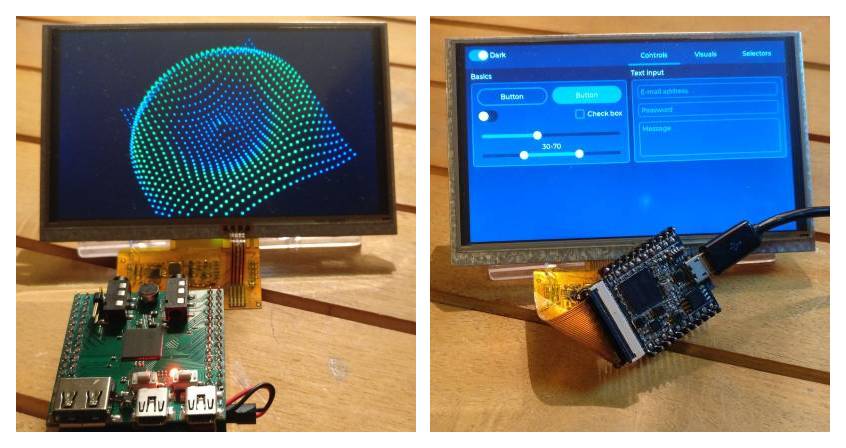

#7 Re: 全志 SOC » Baremetal TinyGL examples » 2023-11-18 22:28:05
kirito wrote:
Textured Cube的例子帧率有多少?
The frame rate depends on the size of the cube and varies from 35 to 11 fps. At the moment when the height of the cube is equal to half the height of the screen, we have 25 fps. Source code with frame rate output to the terminal here: TinyGl Textured Cube Demo

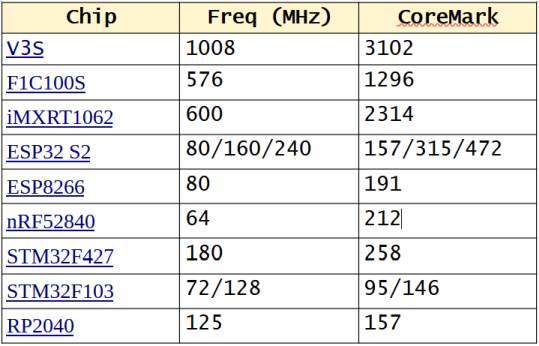

#14 Re: 全志 SOC » CoreMark Benchmark » 2023-06-15 15:02:42
F1C100S CoreMark @ 768MHz: 1729
But do not forget that in addition to processor performance, memory performance is also important.
Allwinner F1C100S Coremark
2K performance run parameters for coremark.
CoreMark Size    : 666
Total ticks      : 14457
Total time (secs): 14.457000
Iterations/Sec   : 1729.266099
Iterations       : 25000
Compiler version : GCC10.3.1 20210824 (release)
Compiler flags   : -O3
Memory location  : STACK
seedcrc          : 0xe9f5
[0]crclist       : 0xe714
[0]crcmatrix     : 0x1fd7
[0]crcstate      : 0x8e3a
[0]crcfinal      : 0xcc42
Correct operation validated. See README.md for run and reporting rules.
CoreMark 1.0 : 1729.266099 / GCC10.3.1 20210824 (release) -O3 / STACK
#15 全志 SOC » CoreMark Benchmark » 2023-06-14 18:54:15
Ozelot
回复: 7
I tested performance of Allwinner's F1C100S and V3S processors on bare metal: F1C100S CoreMark & V3S CoreMark.
Results and comparison with other popular chips:

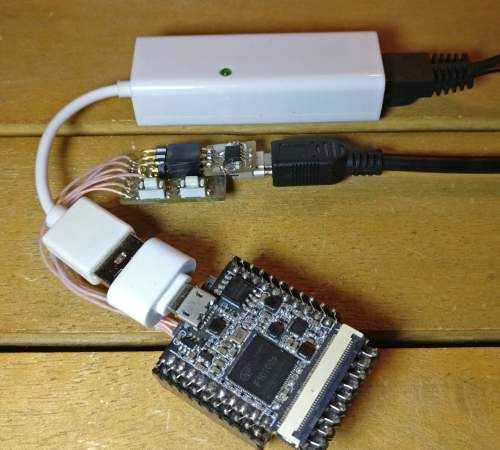

#16 Re: 全志 SOC » Bare metal USB-host example (F1C100S) » 2023-06-05 18:23:59
Example of using USB-Ethernet adapter and lwIP-library.
Adapters based on the RTL8152B chip are supported. The driver from u-boot was taken as the base. This program runs on bare metal and depends on the lwIP TCP/IP stack. In this example, the available services are ping, iperf, and http server. At the same time, iperf demonstrated the use of a bandwidth of more than 90Mbits/sec.
Link: GitHub
#17 全志 SOC » Bare metal USB-host example (F1C100S) » 2023-05-16 18:14:31
Ozelot
回复: 6
This is a simple USB Host implementation in bare metal with supporting Mass Storage Device. In this example, the program reads a file from the drive and copies its contents to another file: GitHub

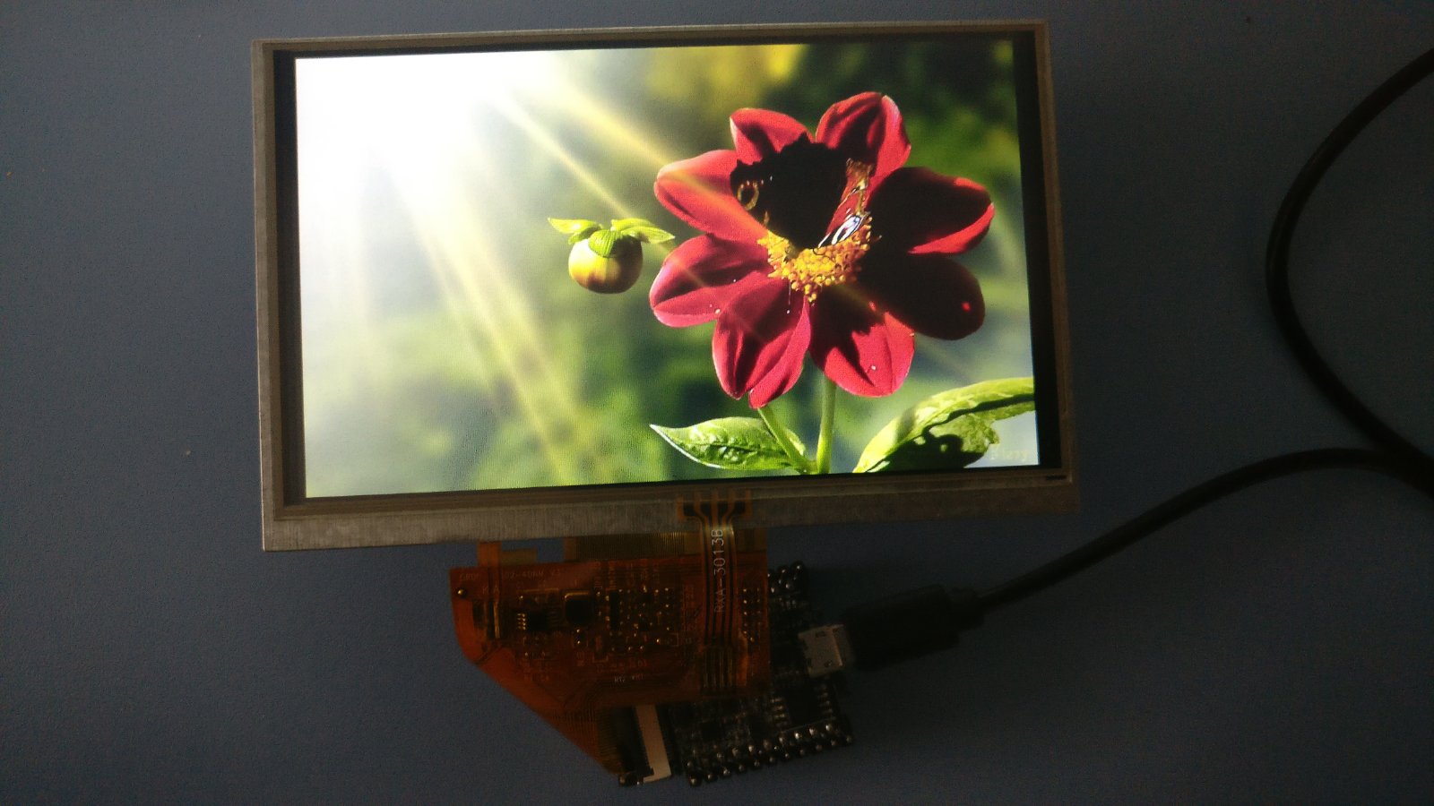

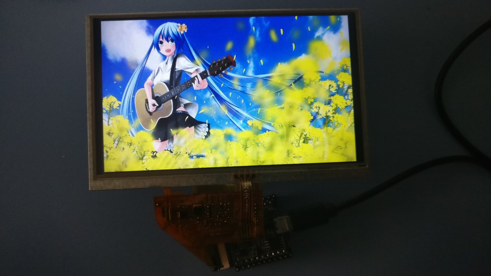

#21 Re: 全志 SOC » Baremetal hardware JPEG-decoder example (F1C100S) » 2022-08-19 19:55:55
Small modification of the previous demo.
Converting tile-based data is done by the mb32dec function. Color conversion - hardware by debe-module.
Decoding time 3-4ms. MB32 transformation 8-9mS. As a result: fps = 1 / (0.004 + 0.009) = 76
Sources: mjpgdec_60fps.7z
60fps video playback example:

#29 Re: 全志 SOC » Baremetal hardware JPEG-decoder example (F1C100S) » 2022-04-26 19:25:26
Simple MJPEG decoding (800x480 @ 25fps)
This example also contains module for working with SD memory card and FATFS library.
The vid directory and its contents must be copied to the root directory of the memory card.
Sources: mjpgdec.7z
#30 Re: 全志 SOC » Baremetal hardware JPEG-decoder example (F1C100S) » 2022-04-24 00:34:19
myxiaonia wrote:
在乌克兰的坛友,你的国家正遭受战争,为你祈祷
Thank you!
There are fights near my city.
We will win!
#31 全志 SOC » Baremetal hardware JPEG-decoder example (F1C100S) » 2022-04-20 15:08:25

#39 全志 SOC » Baremetal TinyGL examples » 2021-11-02 15:34:09
Ozelot
回复: 16
V3S
CPU: 1008MHz
LCD: 800*480
With hardware floating point: 140 fps
With software floating point: 57 fps
v3s_tinygl_gears.7z

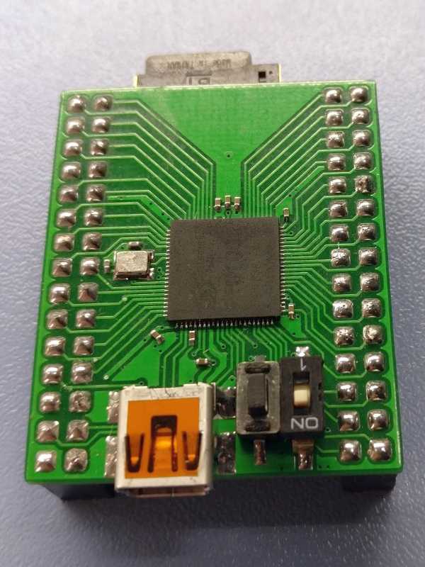

#46 全志 SOC » Simple F1C100S module » 2021-05-11 17:18:35
Ozelot
回复: 4
This is a simple module based on the F1C100S (archive: f1c_cpu.zip)
TOP
BOT
