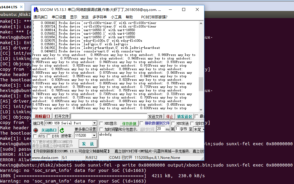

  1. 下载工具链 arm-2014.05-29-arm-none-linux-gnueabi-i686-pc-linux-gnu.tar.bz2,解压缩到 /usr/local/ 目录.
修改 ~/.bashrc 将上面的工具链添加到PATH:
export PATH=/usr/local/arm-2014.05/bin/:$PATH
  1. 下载xboot源码:
3.编译源码:
make PLATFORM=arm32-f1c100s CROSS_COMPILE=arm-linux-
  1. spi flash烧录xboot hack过的固件,插入usb公对公线, 上电,出现sunxi-fel 设备之后, 运行:
sudo sunxi-fel -p write 0x80000000 output/xboot.bin;sudo sunxi-fel exec 0x80000000

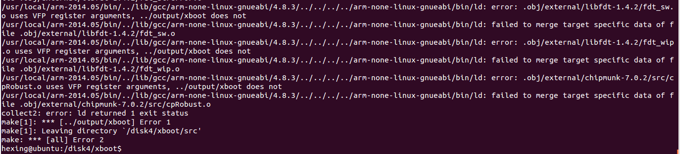

确实, 更新最新的xboot, 使用gcc4.8 链接的时候会出错.
换 gcc-linaro-7.2.1 就正常了。

CROSS_COMPILE ?=arm-linux-gnueabihf-
PLATFORM ?=arm32-f1c100s
链接报错是怎么回事
e:/eclipse-for-xboot-windows-x86_64/compiler/arm-linux-gnueabihf/bin/../lib/gcc/arm-linux-gnueabihf/5.3.1/../../../../arm-linux-gnueabihf/bin/ld.exe: failed to merge target specific data of file .obj/init/version.o
collect2.exe: error: ld returned 1 exit status
make.exe[1]: *** [../output/xboot] Error 1
make.exe[1]: Leaving directory `D:/workbench/TouchView/xboot/src'
make: *** [all] Error 2
应该下载哪一个工具链

root@DESKTOP-SDMPT9S:/mnt/c/Users/ASUS/xboot# make CROSS_COMPILE=/path/to/arm-eabi- PLATFORM=arm32-f1c100s
make[1]: Entering directory '/mnt/c/Users/ASUS/xboot/src'
[AS] arch/arm32/lib/cpu/cache-v7.S
make[1]: /path/to/arm-eabi-gcc: Command not found
Makefile:291: recipe for target '.obj/arch/arm32/lib/cpu/cache-v7.o' failed
make[1]: *** [.obj/arch/arm32/lib/cpu/cache-v7.o] Error 127
make[1]: Leaving directory '/mnt/c/Users/ASUS/xboot/src'
Makefile:8: recipe for target 'all' failed
