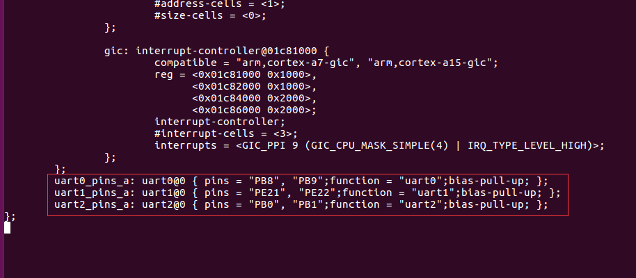

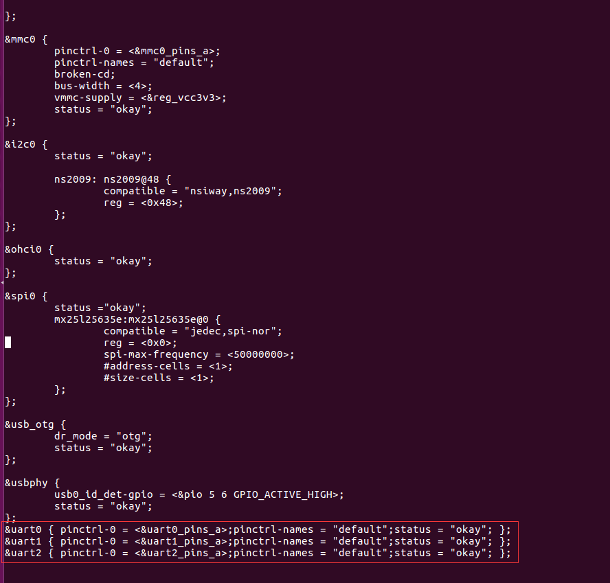

我按照教程试了下,还是有错,提示:
Can't get port settings: Input/output error
Can't initialize device: Invalid argument
配置如下:
sun8i-v3s-licheepi-zero.dts
sun8i-v3s-licheepi-zero.dts配置
sun8i-v3s.dtsi
sun8i-v3s.dtsi配置
