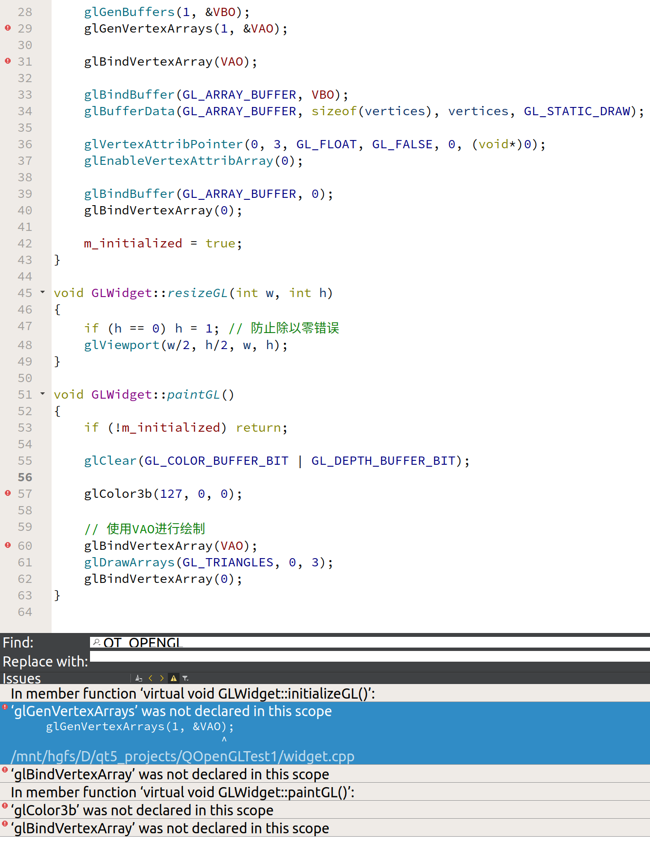

OpenGL ES2 不支持 glGenVertexArrays, glBindVertexArray吗?
class GLWidget : public QOpenGLWidget, protected QOpenGLFunctions_ES2
    Q_OBJECT
public:
    explicit GLWidget(QWidget *parent = nullptr);
    ~GLWidget();
protected:
    void initializeGL() override;
    void resizeGL(int w, int h) override;
    void paintGL() override;
private:
    bool m_initialized;
    GLuint VBO, VAO;
    glGenVertexArrays(1, &VAO);
    glBindVertexArray(VAO);
楼主 #1 2024-08-04 12:33:32
memory
注册时间: 2021-08-11
已发帖子: 725
积分: 705
Re: OpenGL ES2 不支持 glGenVertexArrays, glBindVertexArray吗?
查了一下,要OpenGL ES3.x 才支持 glGenVertexArrays, glBindVertexArray
