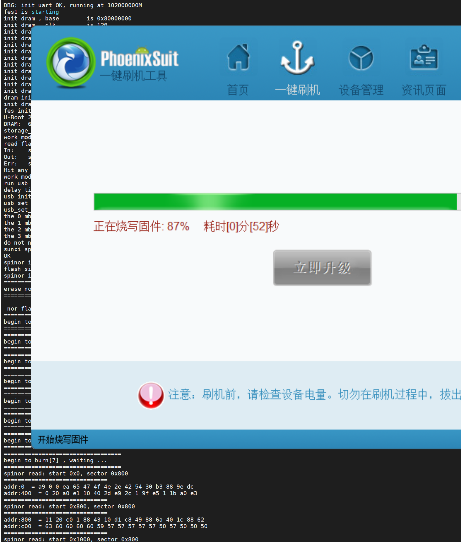

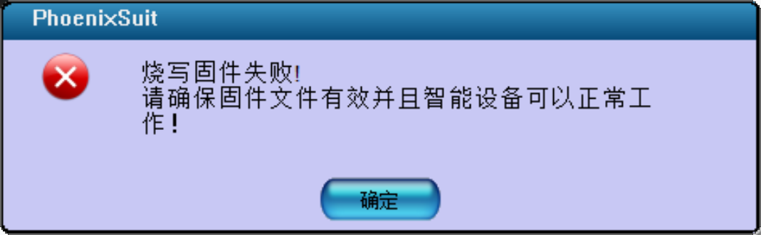

melis 烧录失败,这是什么原因呢?
DBG: init uart OK, running at 102000000M
fes1 is starting
init dram , base        is 0x80000000
init dram , clk         is 120
init dram , access_mode is 1
init dram , cs_num      is 0x00000001
init dram , ddr8_remap  is 0
init dram , sdr_ddr     is 1
init dram , bwidth      is 16
init dram , col_width   is 10
init dram , row_width   is 13
init dram , bank_size   is 4
init dram , cas         is 3
init dram , size        is 120
dram init successed,size is 64
init dram OK, size is 64
fes init dram OK, size is 64
U-Boot 2011.09-rc1-00000-g1d30c34-dirty (Mar 21 2024 - 21:12:43) Allwinner Technology
DRAM:  64 MiB
storage_type: 3
work_mode: 0x10
read flash error
In:    serial
Out:   serial
Err:   serial
work mode=0x10
run usb efex
delay time 2500
usb init ok
usb_set_address_delay_time:15
the 0 mbr table is ok
the 1 mbr table is ok
the 2 mbr table is ok
the 3 mbr table is ok
do not need erase flash
sunxi spinor is initing...
OK
spinor id = 0x1620c2     ret = 0x0
flash size is 4 Mbytes
erase nor flash now , waiting ...
 nor flash erasered finish
begin to burn[0] , waiting ...
begin to burn[1] , waiting ...
begin to burn[2] , waiting ...
begin to burn[3] , waiting ...
begin to burn[4] , waiting ...
begin to burn[5] , waiting ...
begin to burn[6] , waiting ...
begin to burn[7] , waiting ...
spinor read: start 0x0, sector 0x800
addr:0  = 29 0 0 a 61 40 6 0 c 40 44 0 12 80 8c cc
addr:400  = 0 0 a0 e1 10 0 21 80 c 1 e c4 1 13 0 81
spinor read: start 0x800, sector 0x800
addr:800  = 1 20 80 0 80 1 10 80 c8 9 8 48 40 c 0 60
addr:c00  = 41 60 60 60 20 59 43 41 47 15 43 0 57 50 0 50
spinor read: start 0x1000, sector 0x800
addr:1000  = a 52 82 0 a 52 0 80 0 94 0 0 8 12 82 0
addr:1400  = 0 0 0 0 0 0 0 0 0 0 0 0 0 0 0 0
spinor read: start 0x1800, sector 0x800
addr:1800  = 0 0 0 0 0 0 0 0 0 0 0 0 0 0 0 0
addr:1c00  = 0 0 0 0 0 0 0 0 0 0 0 0 0 0 0 0
spinor read: start 0x2000, sector 0x800
addr:2000  = 29 0 0 a 61 40 6 0 c 40 44 0 12 80 8c cc
addr:2400  = 0 0 a0 e1 10 0 21 80 c 1 e c4 1 13 0 81
spinor read: start 0x2800, sector 0x800
addr:2800  = 1 20 80 0 80 1 10 80 c8 9 8 48 40 c 0 60
addr:2c00  = 41 60 60 60 20 59 43 41 47 15 43 0 57 50 0 50
spinor read: start 0x3000, sector 0x800
addr:3000  = a 52 82 0 a 52 0 80 0 94 0 0 8 12 82 0
addr:3400  = 0 0 0 0 0 0 0 0 0 0 0 0 0 0 0 0
spinor read: start 0x3800, sector 0x800
addr:3800  = 0 0 0 0 0 0 0 0 0 0 0 0 0 0 0 0
addr:3c00  = 0 0 0 0 0 0 0 0 0 0 0 0 0 0 0 0
read check sum = 0xd0a16c1a
force sunxi spinor exit
楼主 #1 2024-11-27 11:02:33
memory
注册时间: 2021-08-11
已发帖子: 725
积分: 705
Re: melis 烧录失败,这是什么原因呢?
fes1 is starting
DRAM:  64 MiB
storage_type: 3
work_mode: 0x10
read flash error
In:    serial
Out:   serial
Err:   serial
work mode=0x10
run usb efex
delay time 2500
usb init ok
OK
spinor id = 0x182085     ret = 0x0
flash size is 8 Mbytes
addr:0  = a9 0 0 ea 65 47 4f 4e 2e 42 54 30 b3 88 9e dc
addr:400  = 0 20 a0 e1 10 40 2d e9 2c 1 9f e5 1 1b a0 e3
addr:800  = 11 20 c0 1 88 43 10 d1 c8 49 88 6a 40 1c 88 62
addr:c00  = 63 60 60 60 60 59 57 57 57 57 57 50 57 50 50 50
addr:1000  = 8a ff 82 84 8a ff 82 84 8a ff 82 84 8a ff 82 84
addr:1400  = 3d 4c c8 38 ae c8 b5 a8 2c 65 19 75 2c 89 cf 15
addr:1800  = a c3 4e d6 c5 66 98 11 cb 2d 8d af 72 f4 c0 4a
addr:1c00  = a8 3e 1b 9b 51 88 6f 6f eb 28 a9 fe d2 e9 10 57
addr:2000  = 7f 52 aa a f3 e8 26 0 cc f5 4d 8 1a c1 ed ce
addr:2400  = 32 db f6 e5 d2 f 71 92 e 33 2e d4 fb 97 59 9d
addr:2800  = 1 fe 98 ca 86 b1 f7 ae fe 9 4d 5d 65 ac 70 65
addr:2c00  = c9 f7 fa 6b 34 df 6b 41 4f bd 4b 8d ff fd 84 51
addr:3000  = 4a 52 8a 52 4b 52 34 9a 10 94 29 10 49 12 82 12
read check sum = 0x5a386cac
exit usb
next work 2
SUNXI_UPDATE_NEXT_ACTION_REBOOT
set next system normal
[BOOT0] BOOT0 is starting
DBG: bootinfo error1
换了个8M的flash,可以烧完了,但是不知道有没有起来。
楼主 #2 2024-11-27 15:42:14
memory
注册时间: 2021-08-11
已发帖子: 725
积分: 705
melis v1.7 挂这里了!不知道为啥
楼主 #3 2024-11-27 15:47:36
memory
注册时间: 2021-08-11
已发帖子: 725
积分: 705
请教一下C200S 的官方直接下载V1.6 无法正常启动
https://bbs.aw-ol.com/topic/1833
根据这个帖子搞定了,用 git reset --hard 复位一下源码目录
