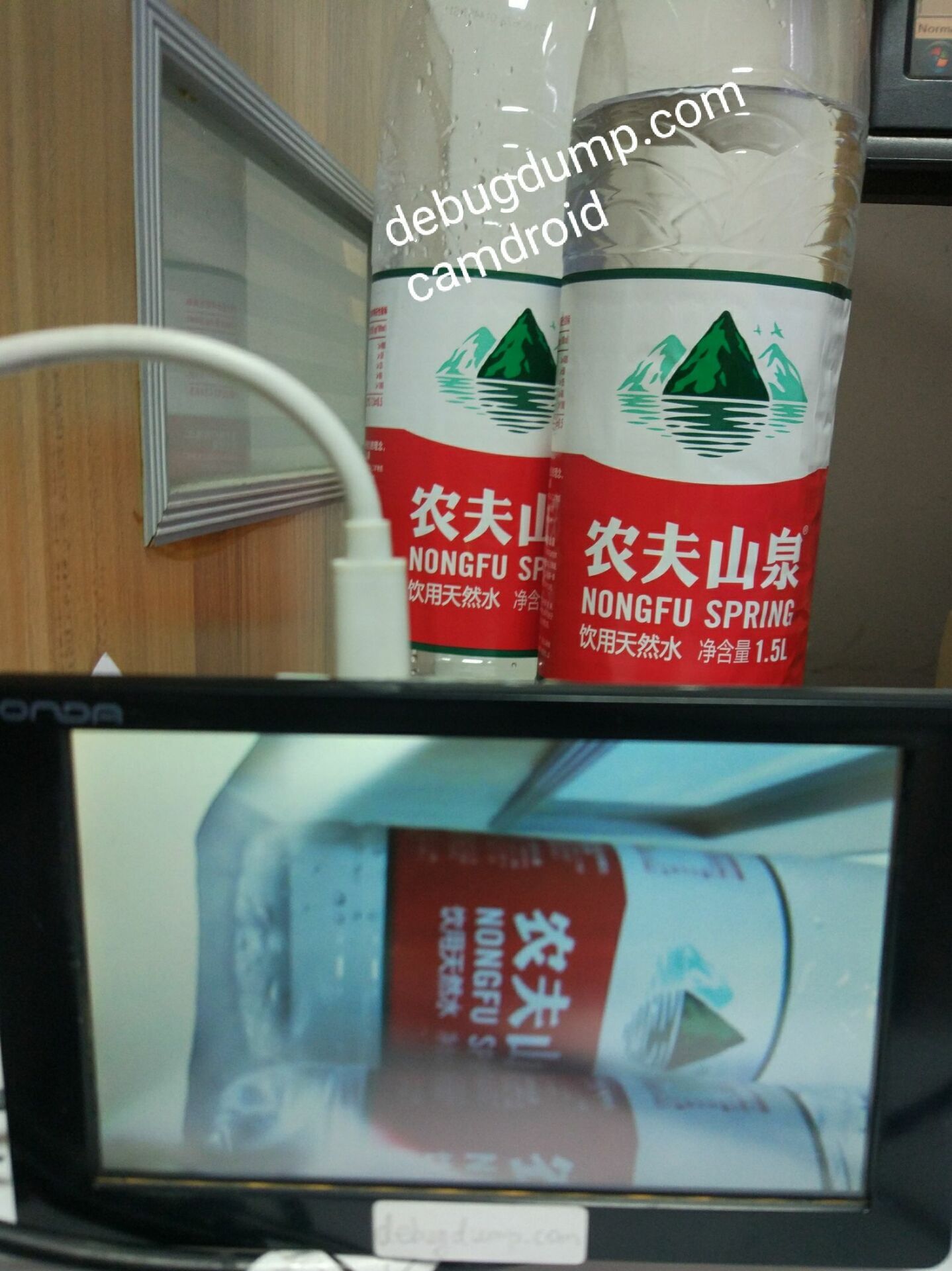

固件下载: zero_ov5647_camdroid_20181022.7z

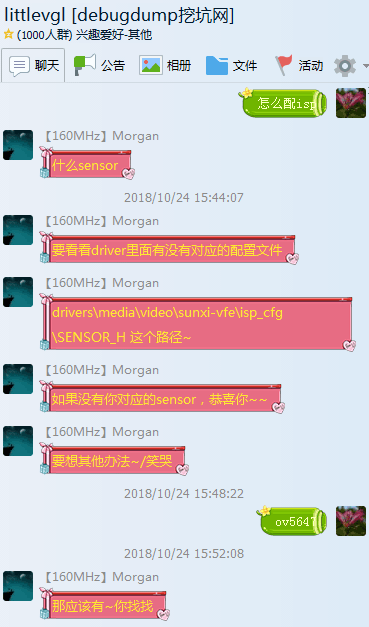

struct isp_cfg_item isp_cfg_array[] =
{ "ov2710_mipi", &ov2710_mipi_isp_cfg, },
{ "ar0330_mipi", &ar0330_mipi_isp_cfg, },
{ "h22_mipi", &h22_mipi_isp_cfg, },
{ "gc1004_mipi", &gc1004_mipi_isp_cfg, },
{ "ov4689", &ov4689_isp_cfg, },

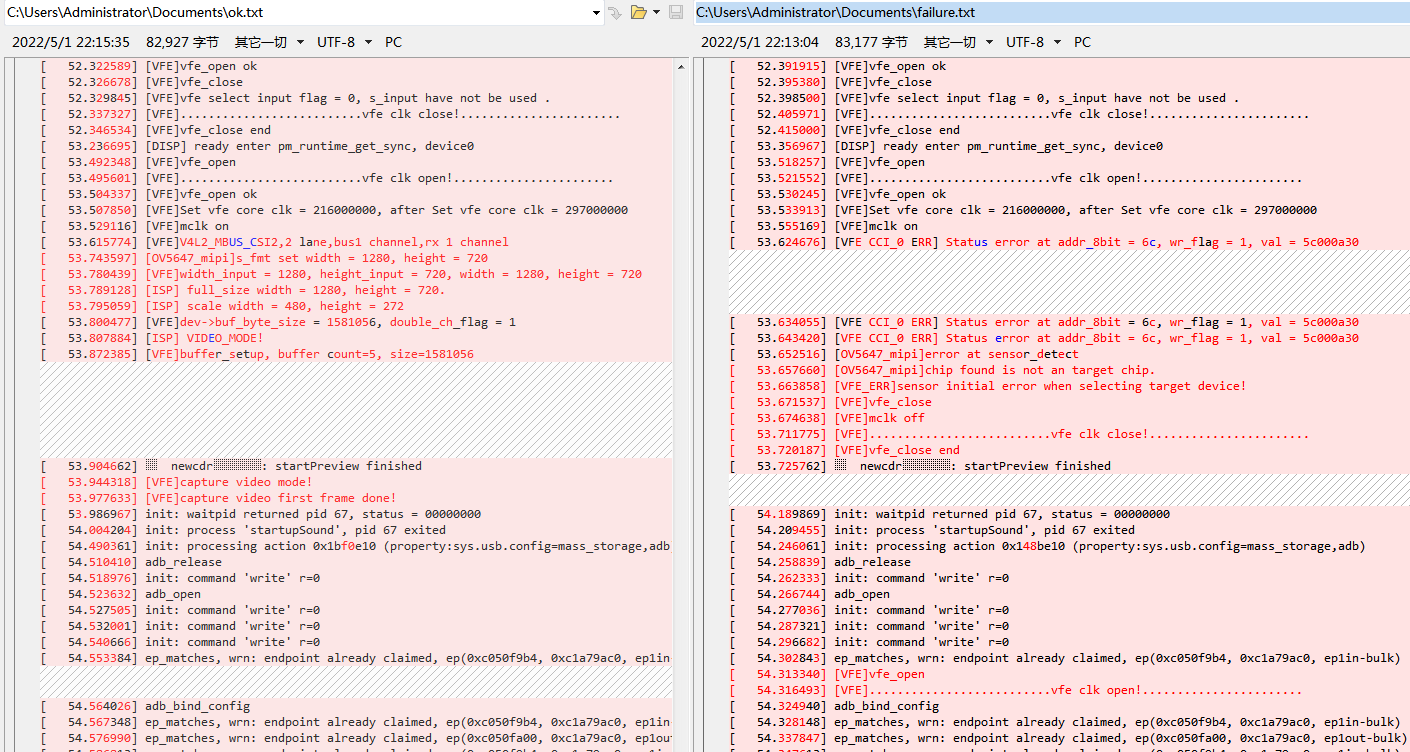

经过 @Morgan 看了一下ISP代码,果然没有包含 ov5647 部分, 赶紧加上去试一试。
在线
在线
camdroid 下怎样拍照?
从上面的图看ov5647效果跟200W的ov2640差不多。

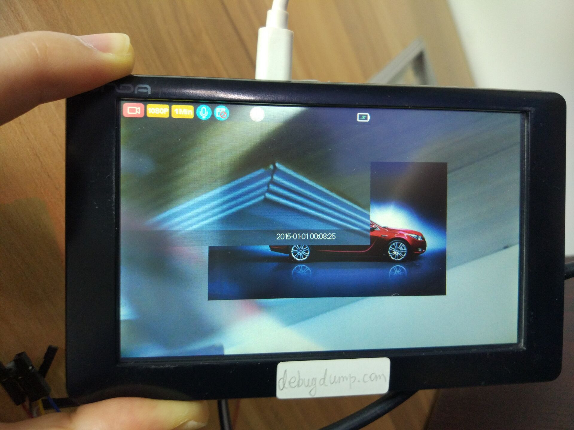

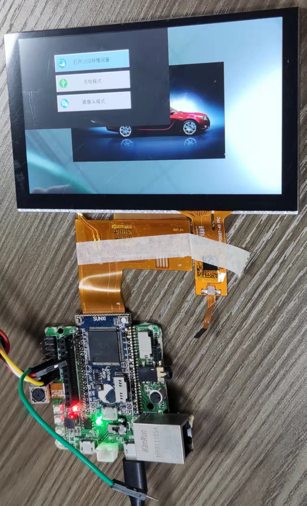

找到几行控制LCD显示的命令:
cd /sys/class/sunxi_dump
echo 01c0c040 800001f5 > write
echo 01c0c040 800001f4 > write
echo 01c0c040 800001f0 > write

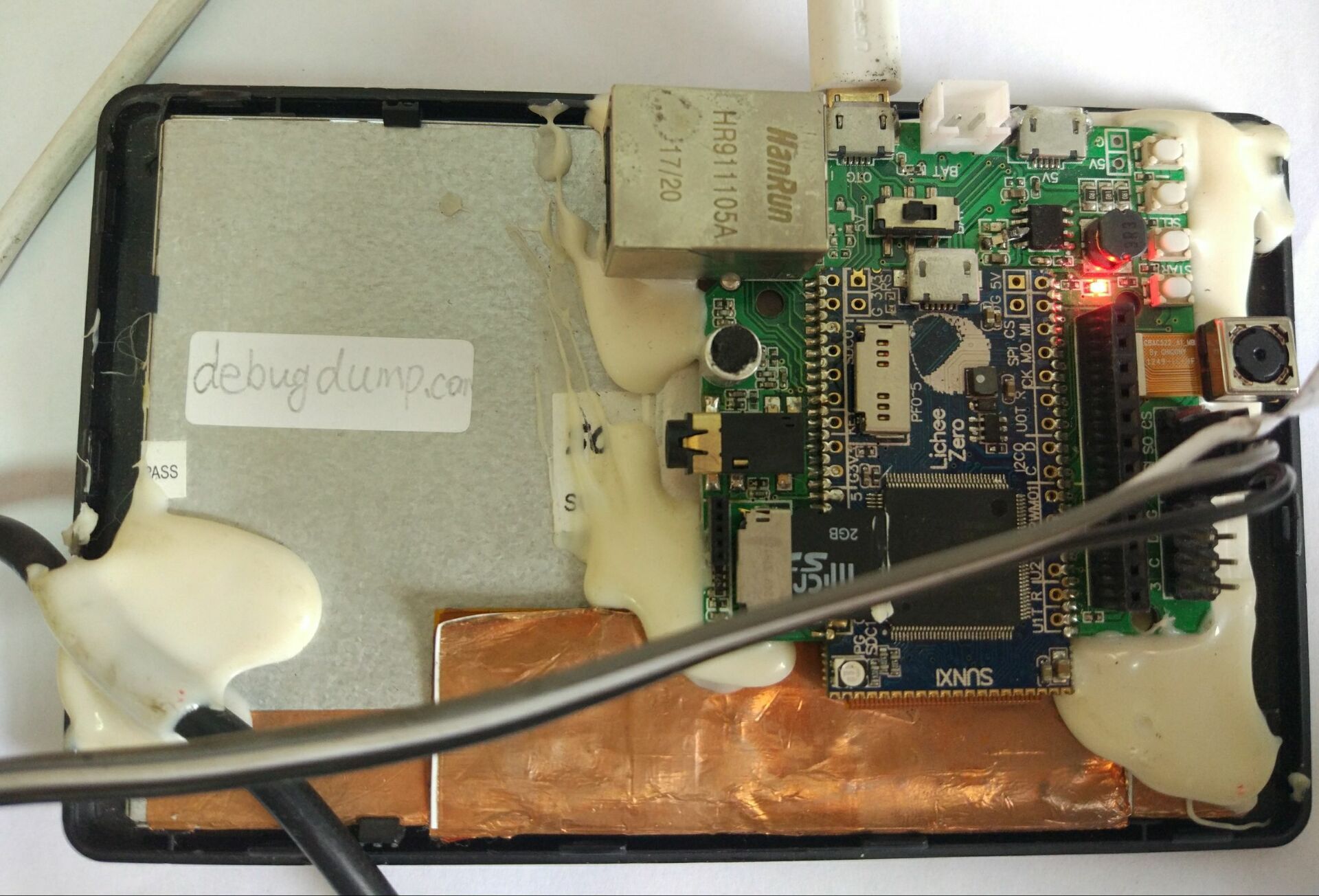

买了个flash刷进去,启动要1分钟。

接串口看下log, 可能是因为没有 pmu芯片, wifi芯片,摄像头重复检测导致的。

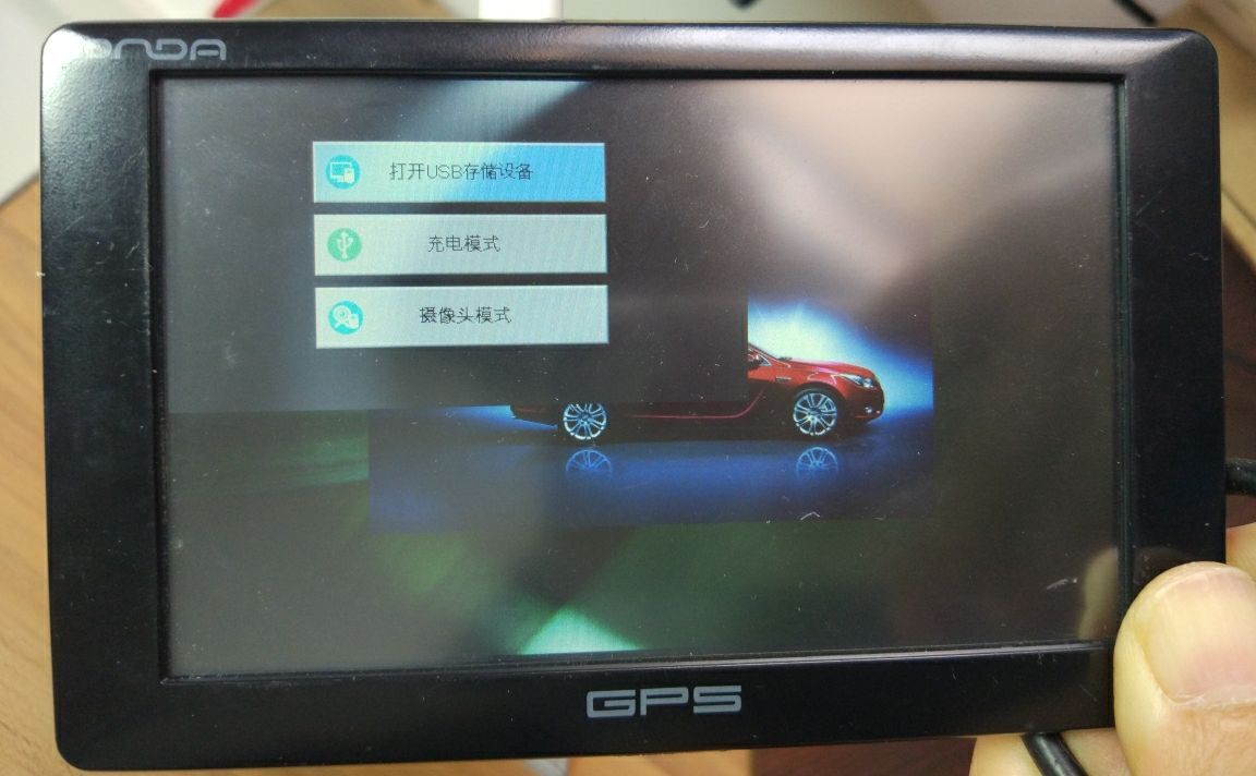

这个固件, 使用荔枝派, 启动后在底板的TF卡座(mmc1)插入TF卡,
执行
echo 1 > /proc/driver/sunxi-mmc.1/insert
会挂载到 /mnt/extsd 目录
执行
echo 0 > /proc/driver/sunxi-mmc.1/insert
会卸载TF卡.

[ 53.437054] [VFE CCI_0 ERR] Status error at addr_8bit = 6c, wr_flag = 1, val = 5c000a30
[ 53.446396] [VFE CCI_0 ERR] Status error at addr_8bit = 6c, wr_flag = 1, val = 5c000a30
[ 53.455701] [VFE CCI_0 ERR] Status error at addr_8bit = 6c, wr_flag = 1, val = 5c000a30
[ 53.464787] [OV5647_mipi]error at sensor_detect
[ 53.470015] [OV5647_mipi]chip found is not an target chip.
[ 53.476198] [VFE_ERR]sensor initial error when selecting target device!

我的LOG是这样的
没有插入摄像头和TF卡
约每10秒输出一次LOG, 不知道为什么?读flash 太慢?

我买了荔枝派v3s的一体板,问过店主摄像头确实是朝里面插的,可是我烧录了楼主提供的固件后,也出现了19楼的问题:
其中也出现了通讯错误的问题,请问如何解决?
[ 53.366289] [VFE]mclk on
[ 53.435801] [VFE CCI_0 ERR] Status error at addr_8bit = 6c, wr_flag = 1, val = 5c000a30
[ 53.445057] [VFE CCI_0 ERR] Status error at addr_8bit = 6c, wr_flag = 1, val = 5c000a30
[ 53.454442] [VFE CCI_0 ERR] Status error at addr_8bit = 6c, wr_flag = 1, val = 5c000a30
[ 53.463523] [OV5647_mipi]error at sensor_detect
[ 53.468670] [OV5647_mipi]chip found is not an target chip.
[ 53.474950] [VFE_ERR]sensor initial error when selecting target device!
[ 53.482519] [VFE]vfe_close
[ 53.485721] [VFE]mclk off
[ 53.522766] [VFE]..........................vfe clk close!.......................
[ 53.531183] [VFE]vfe_close end
[ 53.536840] ▒newcdr▒▒▒▒: startPreview finished

自己回复下,希望后继者少走些弯路。
坑1: MIPI的方向别弄反了,OV5647的头在板子里面,而不是板子外面
坑2: MIPI的PWDN和RST居然没接!!!!!需要自己飞线PG01/PG00到MIPI接口两边的两个上拉电阻
坑3:OV5647的驱动代码把PWDN和RST的极性弄反了,需要将相关ON/OFF对调
#define CSI_RST_ON 0
#define CSI_RST_OFF 1
#define CSI_PWR_ON 1
#define CSI_PWR_OFF 0
最终编译完成之后摄像头就可以用来。如果需要添加ISP的话修改isp_cfg
自己回复下,希望后继者少走些弯路。
#define CSI_PWR_OFF 0最终编译完成之后摄像头就可以用来。如果需要添加ISP的话修改isp_cfg

Update: 坑3是错误的,自己设的坑,把PWDN和RESET飞反了。所以ov5647的代码是不用改的

你的板子和一体板不一样,你的是核心板,连MIPI时PWDN和RESET引脚定义也不一样,但设置都正确了 。我们买的一体板,电路图上的PWDN和RESET都设好了,但奇怪的是MIPI接口却没有连。我是用表测不通之后把MIPI座子焊掉之后才发现连线的地方

晕哥 说:phoenix 说:自己回复下,希望后继者少走些弯路。
感谢分享!
那奇怪,我当时什么都不用改也可以跑起来,
难道是两个版本电路有什么不同吗?你的板子和一体板不一样,你的是核心板,连MIPI时PWDN和RESET引脚定义也不一样,但设置都正确了 。我们买的一体板,电路图上的PWDN和RESET都设好了,但奇怪的是MIPI接口却没有连。我是用表测不通之后把MIPI座子焊掉之后才发现连线的地方
现在已经确认了 : MIPI的PWDN和RST居然没接!!!!!需要自己飞线PG01/PG00到MIPI接口两边的两个上拉电阻 这个么?
https://whycan.cn/files/members/3/QQ20181027135452.jpg
新固件下载: sun8iw8p1_camdroid_tiger-cdr_uart0_licheepi_zero_ov5647_20181027.7z
果然图像亮很多了, 感谢 @Morgan 大神!
调试串口是 UART0(PB8, PB9)
晕哥,这个固件有对应的源码吗?
买了个zero的开发板,烧这个固件进去,屏幕上终于有显示了
