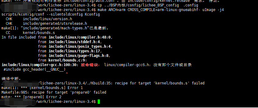

#206 2019-12-12 19:59:24
whyabc666
封禁
注册时间: 2019-12-12
已发帖子: 378
积分: 365
Re: licheepi zero BSP 内核(linux3.4) 编译教程
我编译bsp linux3.4也有错。
make ARCH=arm CROSS_COMPILE=arm-none-linux-gnueabi- uImage -j2
arch/arm/mach-sunxi/pm/standby/gen_check_code: 1: arch/arm/mach-sunxi/pm/standby/gen_check_code: Syntax error: end of file unexpected (expecting ")")
make[3]: *** [arch/arm/mach-sunxi/pm/standby/resume1.code] Error 2
make[2]: *** [arch/arm/mach-sunxi/pm/standby/standby.code] Error 2
make[1]: *** [arch/arm/mach-sunxi/pm] Error 2
make: *** [arch/arm/mach-sunxi] Error 2
make: *** Waiting for unfinished jobs....
kernel/cgroup.c: In function 'cgroup_load_subsys':
kernel/cgroup.c:4167:16: warning: array subscript is below array bounds [-Warray-bounds]
   BUG_ON(subsys[ss->subsys_id] != ss);
include/linux/compiler.h:147:42: note: in definition of macro 'unlikely'
# define unlikely(x) __builtin_expect(!!(x), 0)
kernel/cgroup.c:4167:3: note: in expansion of macro 'BUG_ON'
改arch/arm/mach-sunxi/pm/standby下的makefile
$(obj)/resume1.code: $(obj)/resume1.bin
    #$(Q)$(obj)/gen_check_code $(obj)/resume1.bin $(obj)/super/resume/resume1.code
    cp $(obj)/resume1.bin $(obj)/super/resume/resume1.code
    rm -rf *.o $(obj)/../*.o
搞定

#207 2019-12-12 20:33:20
所在地: 微信 whycan_cn
已发帖子: 9,250
积分: 9197
仔细看前面的帖子,把你的ubuntu换成64bit就可以了。
在线
