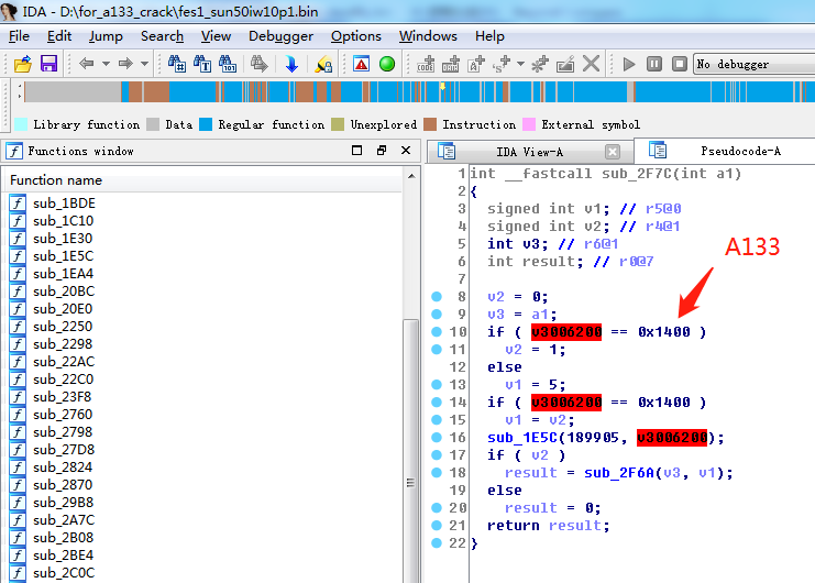

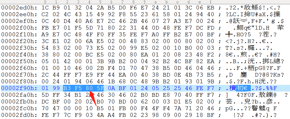

楼主 #2 2023-01-03 19:02:10
yixiuge
注册时间: 2022-04-07
已发帖子: 67
积分: 72
Re: T509/MR813 的boot0 破解给 R818 用
https://armconverter.com/?code=CMP.W%20R3,%20%230X2400
B3F5105F
CMP.W R3, #0x2400
B3F5A05F
CMP.W R3, #0x1400
