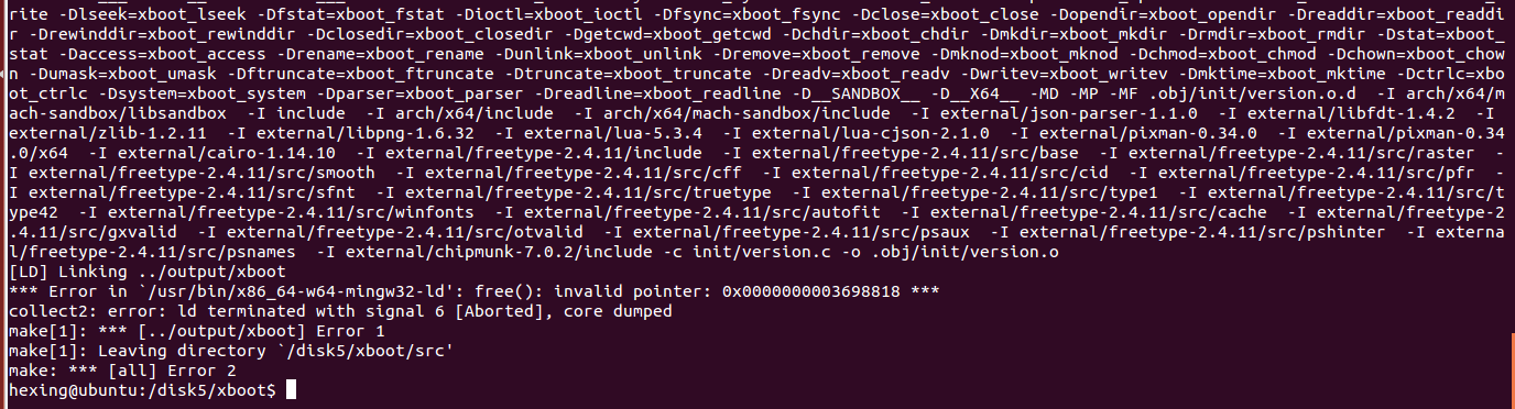

[LD] Linking ../output/xboot
Error in `/usr/bin/x86_64-w64-mingw32-ld': free(): invalid pointer: 0x0000000003698818
collect2: error: ld terminated with signal 6 [Aborted], core dumped
make[1]: *** [../output/xboot] Error 1
make[1]: Leaving directory `/disk5/xboot/src'
make: *** [all] Error 2
只有最后一个链接问题, 解决这个问题就可以在windows跑sandbox了
