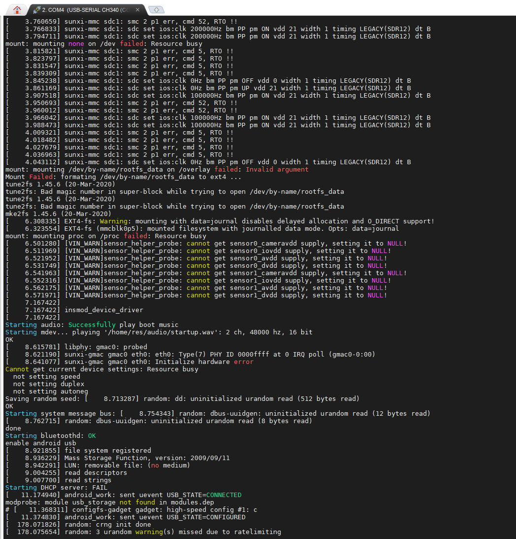

奇怪有一块板启动正常,但是烧录不了:
[128]HELLO! BOOT0 is starting!
[131]BOOT0 commit : {0a84c8b0}
[135][pmu]: bus read error
[137]enable vdd sys auto set
[140]fdt err returned -9
[142]not find dvfs config in spl.dts, default vdd_sys set 0.95V
[148]set pll start
[150]set pll end
[152]dram para13 invalid use default para
[156]vaild para:1  select dram para0
[159]ic board init ok
[161]rtc[7] value = 0x6
[163]enable_jtag
[165]set spi freq:50000000
[169]spi sample_mode:0 sample_delay:1f
[173]spinor id is: ef 40 18, read cmd: 6b
[177]DRAM BOOT DRIVE INFO: V0.21
[180]DRAM use external ZQ
[183]DRAM CLK = 933 MHz
[185]DRAM Type = 3 (3:DDR3,4:DDR4)
[215]DRAM SIZE = 256 MBytes, para1 = 30ea, para2 = 1000001, dram_tpr13 = 8207071
[225]DRAM simple test OK.
[227]dram size = 256
[230]set spi freq:50000000
[234]spi sample_mode:0 sample_delay:1f
[238]spinor id is: ef 40 18, read cmd: 6b
[242]Succeed in reading toc file head.
[245]The size of toc is 1ac000.
[319]Entry_name        = u-boot
[328]Entry_name        = optee
[333]Jump to OPTEE: optee_base = 0x42900000, uboot_base = 0x43500000
M/TC: OP-TEE version: 807754be (gcc version 5.3.1 20160412 (Linaro GCC 5.3-2016.05)) #1 Tue Aug  5 10:07:52 UTC 2025 arm
M/TC: OP-TEE 32bit
[00.516]ns16550_serial serial@2600000: pinctrl_select_state_full: uclass_get_device_by_phandle_id: err=-19

[    0.333144] sunxi:ccu-nglosc not stable, 32K clk will use 16M as parent!
[    0.340206] sunxi:ccu-nglosc not stable, 32K clk will use 16M as parent!
[    0.347266] sunxi:ccu-nglosc not stable, 32K clk will use 16M as parent!
[    0.354325] sunxi:ccu-nglosc not stable, 32K clk will use 16M as parent!
[    0.361386] sunxi:ccu-nglosc not stable, 32K clk will use 16M as parent!
[    0.368446] sunxi:ccu-nglosc not stable, 32K clk will use 16M as parent!
[    0.375505] sunxi:ccu-nglosc not stable, 32K clk will use 16M as parent!
[    0.382565] sunxi:ccu-nglosc not stable, 32K clk will use 16M as parent!
[    0.389625] sunxi:ccu-nglosc not stable, 32K clk will use 16M as parent!
[    0.396693] sunxi:ccu-nglosc not stable, 32K clk will use 16M as parent!
[    0.403753] sunxi:ccu-nglosc not stable, 32K clk will use 16M as parent!
[    0.410812] sunxi:ccu-nglosc not stable, 32K clk will use 16M as parent!
[    0.417872] sunxi:ccu-nglosc not stable, 32K clk will use 16M as parent!
[    0.424931] sunxi:ccu-nglosc not stable, 32K clk will use 16M as parent!
[    0.431991] sunxi:ccu-nglosc not stable, 32K clk will use 16M as parent!
[    0.439051] sunxi:ccu-nglosc not stable, 32K clk will use 16M as parent!
[    0.446110] sunxi:ccu-nglosc not stable, 32K clk will use 16M as parent!
[    0.453170] sunxi:ccu-nglosc not stable, 32K clk will use 16M as parent!
[    0.460230] sunxi:ccu-nglosc not stable, 32K clk will use 16M as parent!
[    0.467299] sunxi:ccu-nglosc not stable, 32K clk will use 16M as parent!
[    0.474359] sunxi:ccu-nglosc not stable, 32K clk will use 16M as parent!
[    0.481419] sunxi:ccu-nglosc not stable, 32K clk will use 16M as parent!
[    0.488479] sunxi:ccu-nglosc not stable, 32K clk will use 16M as parent!
[    0.495538] sunxi:ccu-nglosc not stable, 32K clk will use 16M as parent!
[    0.502598] sunxi:ccu-nglosc not stable, 32K clk will use 16M as parent!
[    0.509658] sunxi:ccu-nglosc not stable, 32K clk will use 16M as parent!
[    0.516717] sunxi:ccu-nglosc not stable, 32K clk will use 16M as parent!
[    0.523777] sunxi:ccu-nglosc not stable, 32K clk will use 16M as parent!
[    0.530837] sunxi:ccu-nglosc not stable, 32K clk will use 16M as parent!
[    0.537905] sunxi:ccu-nglosc not stable, 32K clk will use 16M as parent!
[    0.544965] sunxi:ccu-nglosc not stable, 32K clk will use 16M as parent!
[    0.552025] sunxi:ccu-nglosc not stable, 32K clk will use 16M as parent!
[    0.559084] sunxi:ccu-nglosc not stable, 32K clk will use 16M as parent!
[    0.566143] sunxi:ccu-nglosc not stable, 32K clk will use 16M as parent!
[    0.573203] sunxi:ccu-nglosc not stable, 32K clk will use 16M as parent!
[    0.580263] sunxi:ccu-nglosc not stable, 32K clk will use 16M as parent!
[    0.587323] sunxi:ccu-nglosc not stable, 32K clk will use 16M as parent!
[    0.594382] sunxi:ccu-nglosc not stable, 32K clk will use 16M as parent!
[    0.601442] sunxi:ccu-nglosc not stable, 32K clk will use 16M as parent!
[    0.608510] sunxi:ccu-nglosc not stable, 32K clk will use 16M as parent!
[    0.615570] sunxi:ccu-nglosc not stable, 32K clk will use 16M as parent!
[    0.622629] sunxi:ccu-nglosc not stable, 32K clk will use 16M as parent!
[    0.629689] sunxi:ccu-nglosc not stable, 32K clk will use 16M as parent!
[    0.636748] sunxi:ccu-nglosc not stable, 32K clk will use 16M as parent!
[    0.643808] sunxi:ccu-nglosc not stable, 32K clk will use 16M as parent!
[    0.650868] sunxi:ccu-nglosc not stable, 32K clk will use 16M as parent!
[    0.657927] sunxi:ccu-nglosc not stable, 32K clk will use 16M as parent!
[    0.664987] sunxi:ccu-nglosc not stable, 32K clk will use 16M as parent!
[    0.672047] sunxi:ccu-nglosc not stable, 32K clk will use 16M as parent!
[    0.679115] sunxi:ccu-nglosc not stable, 32K clk will use 16M as parent!
[    0.686174] sunxi:ccu-nglosc not stable, 32K clk will use 16M as parent!
[    0.693234] sunxi:ccu-nglosc not stable, 32K clk will use 16M as parent!
[    0.700294] sunxi:ccu-nglosc not stable, 32K clk will use 16M as parent!
[    0.707354] sunxi:ccu-nglosc not stable, 32K clk will use 16M as parent!
[    0.714414] sunxi:ccu-nglosc not stable, 32K clk will use 16M as parent!
[    0.721473] sunxi:ccu-nglosc not stable, 32K clk will use 16M as parent!
[    0.728533] sunxi:ccu-nglosc not stable, 32K clk will use 16M as parent!
[    0.735593] sunxi:ccu-nglosc not stable, 32K clk will use 16M as parent!
[    0.742652] sunxi:ccu-nglosc not stable, 32K clk will use 16M as parent!
[    0.749721] sunxi:ccu-nglosc not stable, 32K clk will use 16M as parent!
[    0.756781] sunxi:ccu-nglosc not stable, 32K clk will use 16M as parent!
[    0.763841] sunxi:ccu-nglosc not stable, 32K clk will use 16M as parent!
[    0.770900] sunxi:ccu-nglosc not stable, 32K clk will use 16M as parent!
[    0.777960] sunxi:ccu-nglosc not stable, 32K clk will use 16M as parent!
[    0.785020] sunxi:ccu-nglosc not stable, 32K clk will use 16M as parent!
[    0.792079] sunxi:ccu-nglosc not stable, 32K clk will use 16M as parent!
[    0.799138] sunxi:ccu-nglosc not stable, 32K clk will use 16M as parent!
[    0.806198] sunxi:ccu-nglosc not stable, 32K clk will use 16M as parent!
[    0.813258] sunxi:ccu-nglosc not stable, 32K clk will use 16M as parent!
[    0.820332] sunxi:ccu-nglosc not stable, 32K clk will use 16M as parent!
[    0.827392] sunxi:ccu-nglosc not stable, 32K clk will use 16M as parent!
[    0.834452] sunxi:ccu-nglosc not stable, 32K clk will use 16M as parent!
[    0.841512] sunxi:ccu-nglosc not stable, 32K clk will use 16M as parent!
[    0.848571] sunxi:ccu-nglosc not stable, 32K clk will use 16M as parent!
[    0.855631] sunxi:ccu-nglosc not stable, 32K clk will use 16M as parent!
[    0.862690] sunxi:ccu-nglosc not stable, 32K clk will use 16M as parent!
[    0.869750] sunxi:ccu-nglosc not stable, 32K clk will use 16M as parent!
[    0.876810] sunxi:ccu-nglosc not stable, 32K clk will use 16M as parent!
[    0.883869] sunxi:ccu-nglosc not stable, 32K clk will use 16M as parent!
[    0.890937] sunxi:ccu-nglosc not stable, 32K clk will use 16M as parent!
[    0.897997] sunxi:ccu-nglosc not stable, 32K clk will use 16M as parent!
[    0.905057] sunxi:ccu-nglosc not stable, 32K clk will use 16M as parent!
[    0.912117] sunxi:ccu-nglosc not stable, 32K clk will use 16M as parent!
[    0.919176] sunxi:ccu-nglosc not stable, 32K clk will use 16M as parent!
[    0.926237] sunxi:ccu-nglosc not stable, 32K clk will use 16M as parent!
[    0.933296] sunxi:ccu-nglosc not stable, 32K clk will use 16M as parent!
[    0.940356] sunxi:ccu-nglosc not stable, 32K clk will use 16M as parent!
[    0.947416] sunxi:ccu-nglosc not stable, 32K clk will use 16M as parent!
[    0.948788] sunxi:ccu-ng:[INFO]: rtc_ccu: sunxi ccu init OK
[    0.954605] sunxi:ccu-ng:[INFO]: cpupll_ccu: sunxi ccu init OK
[    0.959871] sunxi:ccu-ng:[INFO]: sunxi cpupll driver version: 0.0.1
[    0.966414] sunxi:ccu-ng:[INFO]: r_ccu: sunxi ccu init OK
[    0.971718] sunxi:ccu-ng:[INFO]: drampll_ccu: sunxi ccu init OK
[    0.977341] sun8iw22-pll-dram 3130000.drampll_ccu: sunxi:ccu-ngsun8iw22 pll clk init OK
[    1.005333] SCSI subsystem initialized
[    1.005645] usbcore: registered new interface driver usbfs
[    1.008960] usbcore: registered new interface driver hub
[    1.014242] usbcore: registered new device driver usb
[    1.019357] mc: Linux media interface: v0.10
[    1.023618] videodev: Linux video capture interface: v2.00
[    1.028985] pps_core: LinuxPPS API ver. 1 registered
[    1.033926] pps_core: Software ver. 5.3.6 - Copyright 2005-2007 Rodolfo Giometti <giometti@linux.it>
[    1.042993] PTP clock support registered
[    1.047182] Advanced Linux Sound Architecture Driver Initialized.
[    1.058464] sun6i-dma 3001000.dma-controller: sunxi:dmasunxi dma probed, driver version: 1.2.15
[    1.063052] sunxi:pwmcs-20a0000.pwmcs0:[INFO]: start probe
[    1.063092] sunxi:pwmcs-20a0000.pwmcs0:[INFO]: chip->pwmcs_num:0
[    1.073088] sunxi:pwmcs-20a0000.pwmcs0:[ERR]: base is 0, num is 8
[    1.079667] sunxi:pwmcs-20a0000.pwmcs0:[INFO]: pwmcschip probe success
[    1.086017] sunxi:pwmcs-20b0000.pwmcs1:[INFO]: start probe
[    1.086052] sunxi:pwmcs-20b0000.pwmcs1:[INFO]: chip->pwmcs_num:1
[    1.097115] sunxi:pwmcs-20b0000.pwmcs1:[ERR]: base is 8, num is 8
[    1.103578] sunxi:pwmcs-20b0000.pwmcs1:[INFO]: pwmcschip probe success
[    1.110096] sunxi:pwm-20c0000.pwm2:[INFO]: start probe
[    1.110139] sunxi:pwm-20c0000.pwm2:[WARN]: invalid PWM alias format: pwmcs0
[    1.121673] sunxi:pwm-20c0000.pwm2:[WARN]: invalid PWM alias format: pwmcs1
[    1.129222] sunxi:pwm-20c0000.pwm2:[INFO]: pwmchip probe success
[    1.134889] clocksource: Switched to clocksource arch_sys_counter
[    1.153444] sunxi:pin-3604000.pinctrl:[INFO]: pinctrl withstand voltage config mode=auto_hard
[    1.156379] sunxi:pin:[INFO]: sunxi pinctrl core driver version: 1.4.19
[    1.164775] sunxi:pin-7096500.pinctrl:[INFO]: pinctrl withstand voltage config mode=auto_hard
[    1.171921] NET: Registered protocol family 2
[    1.175979] IP idents hash table entries: 4096 (order: 3, 32768 bytes, linear)
[    1.183863] tcp_listen_portaddr_hash hash table entries: 512 (order: 0, 6144 bytes, linear)
[    1.191335] TCP established hash table entries: 2048 (order: 1, 8192 bytes, linear)
[    1.198927] TCP bind hash table entries: 2048 (order: 2, 16384 bytes, linear)
[    1.206200] TCP: Hash tables configured (established 2048 bind 2048)
[    1.212417] UDP hash table entries: 256 (order: 1, 8192 bytes, linear)
[    1.218884] UDP-Lite hash table entries: 256 (order: 1, 8192 bytes, linear)
[    1.225942] NET: Registered protocol family 1
[    1.231343] workingset: timestamp_bits=30 max_order=16 bucket_order=0
[    1.240718] squashfs: version 4.0 (2009/01/31) Phillip Lougher
[    1.242311] ntfs: driver 2.1.32 [Flags: R/W].
[    1.246994] jffs2: version 2.2. (NAND) © 2001-2006 Red Hat, Inc.
[    1.253253] Block layer SCSI generic (bsg) driver version 0.4 loaded (major 245)
[    1.260106] io scheduler mq-deadline registered
[    1.264582] io scheduler kyber registered
[    1.277587] scsi host0: scsi_debug: version 0190 [20200710]
[    1.277587]   dev_size_mb=8, opts=0x0, submit_queues=1, statistics=0
[    1.284501] scsi 0:0:0:0: Direct-Access     Linux    scsi_debug       0190 PQ: 0 ANSI: 7
[    1.292546] sd 0:0:0:0: Power-on or device reset occurred
[    1.298676] CAN device driver interface
[    1.301777] ehci_hcd: USB 2.0 'Enhanced' Host Controller (EHCI) Driver
[    1.307745] ohci_hcd: USB 1.1 'Open' Host Controller (OHCI) Driver
[    1.314040] usbcore: registered new interface driver uas
[    1.319284] sd 0:0:0:0: [sda] 16384 512-byte logical blocks: (8.39 MB/8.00 MiB)
[    1.326460] usbcore: registered new interface driver usb-storage
[    1.332340] usbcore: registered new interface driver ums-alauda
[    1.336429] sd 0:0:0:0: [sda] Write Protect is off
[    1.338245] usbcore: registered new interface driver ums-cypress
[    1.342970] sd 0:0:0:0: [sda] Mode Sense: 73 00 10 08
[    1.348991] usbcore: registered new interface driver ums-datafab
[    1.359997] usbcore: registered new interface driver ums_eneub6250
[    1.366149] usbcore: registered new interface driver ums-freecom
[    1.372114] usbcore: registered new interface driver ums-isd200
[    1.374074] sd 0:0:0:0: [sda] Write cache: enabled, read cache: enabled, supports DPO and FUA
[    1.378022] usbcore: registered new interface driver ums-jumpshot
[    1.392571] usbcore: registered new interface driver ums-karma
[    1.398407] usbcore: registered new interface driver ums-realtek
[    1.404355] usbcore: registered new interface driver ums-sddr09
[    1.410261] usbcore: registered new interface driver ums-sddr55
[    1.416156] usbcore: registered new interface driver ums-usbat
[    1.416613] sd 0:0:0:0: [sda] Optimal transfer size 524288 bytes
[    1.422207] i2c /dev entries driver
[    1.431477] usbcore: registered new interface driver uvcvideo
[    1.437109] USB Video Class driver (1.1.1)
[    1.441365] sunxi:pin-3604000.pinctrl:[INFO]: Auto power withstand voltage configuration detected, automatically exit!
[    1.452222] ledtrig-cpu: registered to indicate activity on CPUs
[    1.457985] usbcore: registered new interface driver usbhid
[    1.463346] usbhid: USB HID core driver
[    1.467224] optee: probing for conduit method.
[    1.471596] optee: revision 3.7 (807754be)
[    1.472149] optee: initialized driver
[    1.480329] uart-ng uart-ng0: supply uart not found, using dummy regulator
[    1.486353] sunxi:uart-ng-uart-ng0:[INFO]: cannot get the TX DMA channel!
[    1.492905] sunxi:uart-ng-uart-ng0:[INFO]: cannot get the RX DMA channel!
[    1.499730] sunxi:uart-ng:[INFO]: sunxi uart-ng driver version: 1.1.21
[    1.506207] uart-ng0: ttyAS0 at MMIO 0x2600000 (irq = 46, base_baud = 1500000) is a SUNXI
[    1.514326] sunxi:uart-ng-uart-ng0:[INFO]: console setup baud 115200 parity n bits 8, flow n
[    1.522834] printk: console [ttyAS0] enabled
[    1.533195] printk: bootconsole [earlycon0] disabled
[    1.543841] sunxi:rtc:[INFO]:  Saving SoC boot-reason: OTHERS
[    1.554389] sunxi:rtc:[INFO]:  Saving SoC boot-reason: HARDREST-BOOT
[    1.561637] sunxi:rtc-7090000.rtc:[WARN]: Warning: Using internal RC 16M clock source. Time may be inaccurate!
[    1.572976] sunxi:rtc-7090000.rtc:[WARN]: Warning: Using internal RC 16M clock source. Time may be inaccurate!
[    1.584227] sunxi:rtc-7090000.rtc:[WARN]: Warning: Using internal RC 16M clock source. Time may be inaccurate!
[    1.595759] sunxi-rtc 7090000.rtc: registered as rtc0
[    1.601425] sunxi:rtc-7090000.rtc:[WARN]: Warning: Using internal RC 16M clock source. Time may be inaccurate!
[    1.612697] sunxi-rtc 7090000.rtc: setting system clock to 1970-01-01T00:03:37 UTC (217)
[    1.614030] sd 0:0:0:0: [sda] Attached SCSI disk
[    1.621793] sunxi:rtc-7090000.rtc:[INFO]: sunxi rtc probed
[    1.634104] sunxi-wdt 2050000.watchdog: Watchdog enabled (timeout=16 sec, nowayout=0), driver version: 1.0.4
[    1.646295] sunxi:sunxi_spif-2800000.spif:[INFO]: sample_mode:0 sample_delay:1f
[    1.654914] sunxi:sunxi_spif-2800000.spif:[INFO]: [spi-flash0] mclk 25000000
[    1.664478] sunxi:sunxi_spif-2800000.spif:[INFO]: [spi-flash0] working clk 80000000
[    1.674092] sunxi_spif 2800000.spif: w25q128 (16384 Kbytes)
[    1.682065] 8 sunxipart partitions found on MTD device spif
[    1.688330] Creating 8 MTD partitions on "spif":
[    1.693509] 0x000000000000-0x000000200000 : "uboot"
[    1.705812] 0x000000200000-0x000000220000 : "boot-resource"
[    1.715786] 0x000000220000-0x000000240000 : "env"
[    1.725759] 0x000000240000-0x0000007e0000 : "boot"
[    1.735748] 0x0000007e0000-0x000001070000 : "rootfs"
[    1.741320] mtd: partition "rootfs" extends beyond the end of device "spif" -- size truncated to 0x820000
[    1.755729] 0x000001070000-0x000001080000 : "private"
[    1.761395] mtd: partition "private" is out of reach -- disabled
[    1.775746] 0x000001080000-0x000001100000 : "rootfs_data"
[    1.781802] mtd: partition "rootfs_data" is out of reach -- disabled
[    1.795719] 0x000001100000-0x0000011fc000 : "UDISK"
[    1.801188] mtd: partition "UDISK" is out of reach -- disabled
[    1.815740] sunxi:sunxi_spif-2800000.spif:[INFO]: probe succeed (Version 2.0.0)

[    6.064532] blk_update_request: I/O error, dev mtdblock7, sector 0 op 0x0:(READ) flags 0x800 phys_seg 1 prio class 0
[    6.076416] SQUASHFS error: Failed to read block 0x0: -5
[    6.082378] unable to read squashfs_super_block
formating  /dev/by-name/UDISK to jffs2...
/etc/partition_op.sh: line 34: mkfs.jffs2: command not found
dd: can't open '/tmp/jffs2.img': No such file or directory
[    6.176455] Too few erase blocks (0)
mount: mounting /dev/by-name/UDISK on /mnt/UDISK failed: Invalid argument
[    6.285040] sunxi_usb_udc 4200000.udc-controller: supply udc not found, using dummy regulator

[736]fes begin commit:{0a84c8b0}
[740][pmu]: bus read error
[743]set pll start
[744]set pll end
[746]dram para13 invalid use default para
[750]vaild para:1  select dram para0
[753]ic board init ok
[755]beign to init dram
[757]DRAM BOOT DRIVE INFO: V0.21
[760]DRAM use external ZQ
[930][AUTO DEBUG] 16bit, 1 rank training success
[991][AUTO DEBUG] row = 14, col = 10, bank = 3, bg = 0
[996][AUTO DEBUG] para1 = 0x30ea, para2 = 0x1, tpr13 = 0x8207071
[1002][SOFT TRAINING] Version: T2.5
[1005]Soft Training Version: T2.5
[1008][SOFT TRAINING] Dram Soft Training Loop1
[1247][SOFT TRAINING] Stable test, dram_clk=480,dram_tpr12=0x13131313,memtest pass
[1281][SOFT TRAINING] Start rdq vref training
[3373][SOFT TRAINING]  Highest r vref: 0x4-0x78, high=0x76(766mV), delay=31
[3380][SOFT TRAINING]  Max Vref=0x3e, Widest vref is 0x24~0x5c, center=0x40
[3387][SOFT TRAINING] After rdq00 vref training, dram_add[16] = 0x40404040
[3393][SOFT TRAINING] Start rdq vref training
[4289][SOFT TRAINING]  Highest r vref: 0x4-0x7a, high=0x78(779mV), delay=29
[4295][SOFT TRAINING]  Max Vref=0x38, Widest vref is 0x24~0x58, center=0x3e
[4302][SOFT TRAINING] After rdq01 vref training, dram_add[16] = 0x40403e40

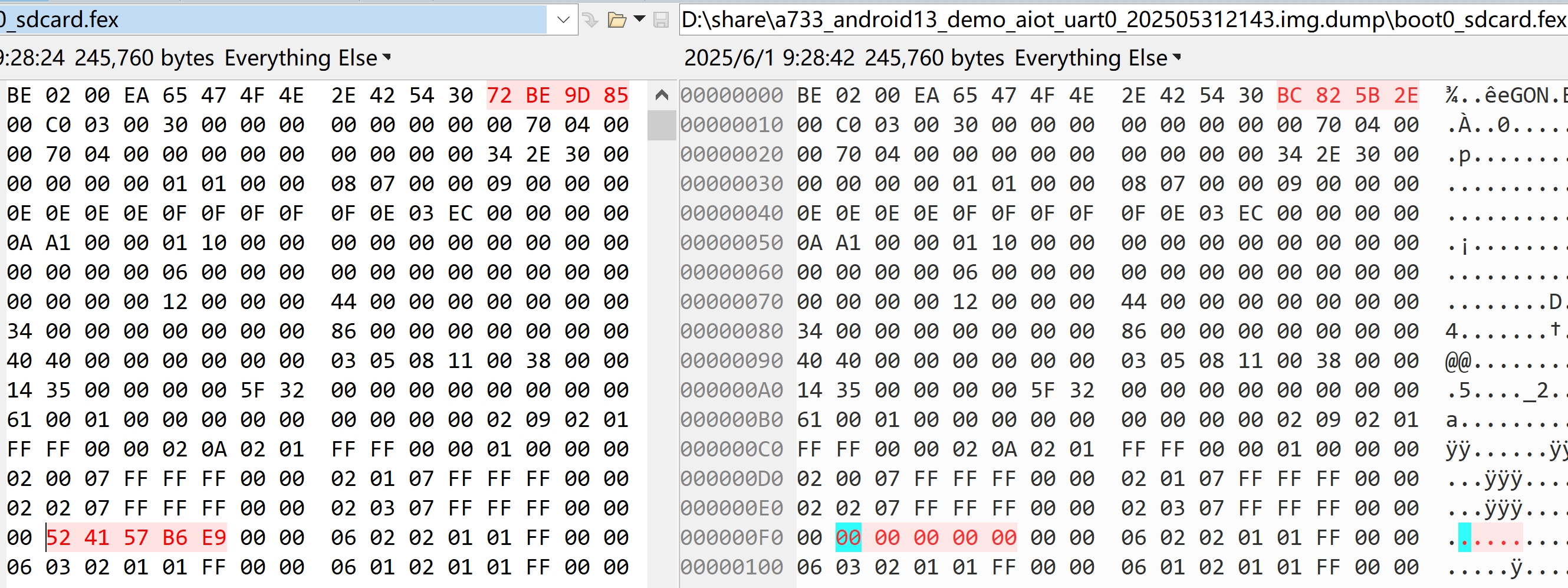

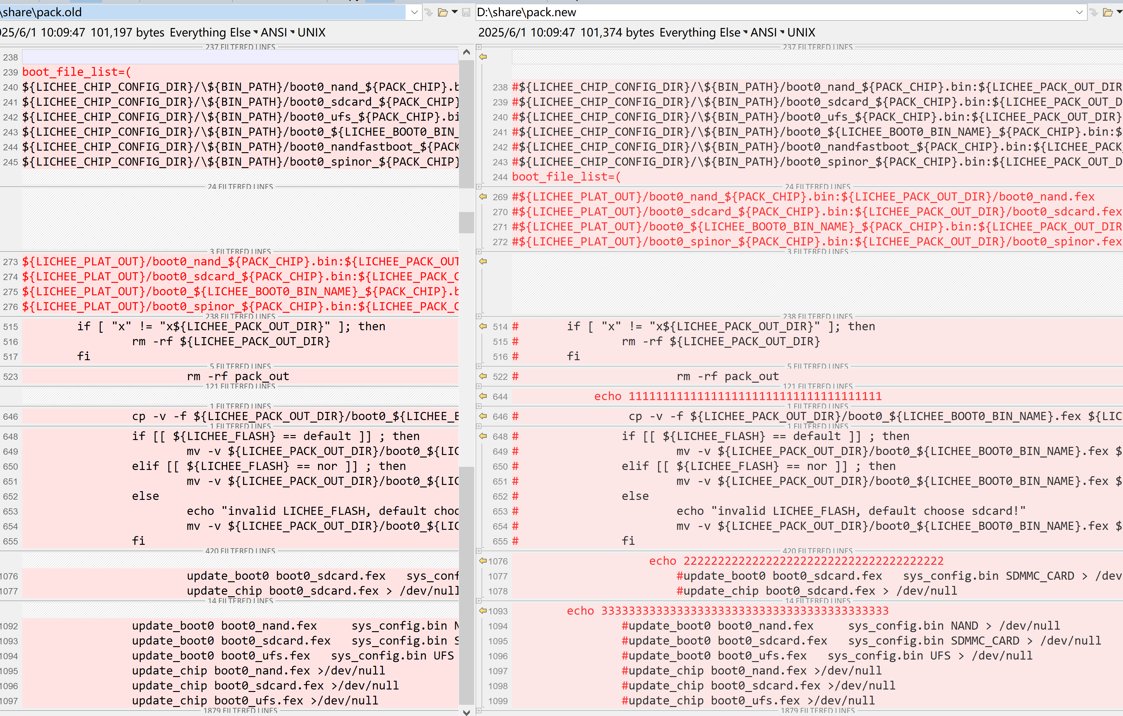

#119 Re: Qt/MSVC/MINGW/C++/MFC/GTK+/Delphi/BCB » T113 S3 » 2025-06-02 16:32:24
可能是播放导致了短路,CPU温度上升到了111℃。
#120 Re: 全志 SOC » 九鼎创展 A733 开发板使用记录 » 2025-06-01 10:08:02
现在基本确定了,就是打包工具导致 boot0_*.fex 几个文件并没有更新成功
折腾半小时,修改 longan/build/pack 脚本,从正常的img提取出来的boot0_*.fex 复制到 longan/out/a733/demo_aiot/pack_out/ 目录,
然后强制 boot0_*.fex 不更新
